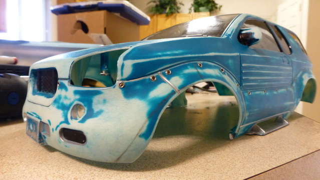

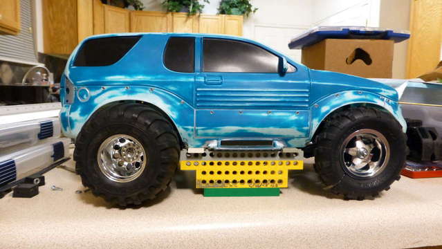

I started doing some clean-up on the shell by sanding down the parting lines & removing some excess paint:

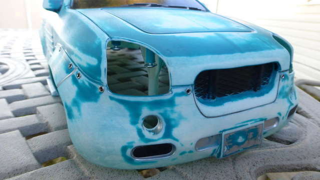

I decided to add some set-screws to the body cladding for effect. I also carved out the shape of the grill insert for realism/accuracy. Not too shabby for a first try!:
Obviously, I would have to cut out the wheel openings:

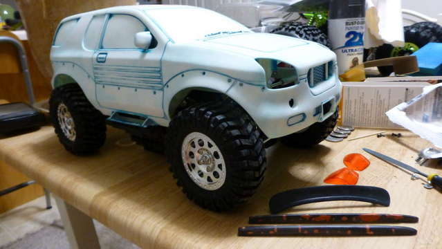

Things were looking promising so the parts hunt began with tires!
I needed something around a 35"-37" scale tire & the Mickeys are perfect!
Yeah, I ordered a winch too so had to cut out a spot to mount it (just taped in place). Nice headlight lenses, aye? :roll::
I figured out what rims would give me the least track-width & ordered 'em up! RC4WD Enduros fit the bill:
So essentially 37" tires on 20" rims.
Otherwise... I will be reworking the body to better resemble an actual VX.
The shape of the headlights are off - too boxy.
Front bumper cladding looks pug-nosed.
Front bumper cladding seam is too low.
C-Pillar is shaped wrong.
Tailights are too big & squared off.
Hood line at windshield is wrong.
Mirrors look goofy.
Rear window is mis-shaped.
Door seam shapes are not accurate enough.
Fangs need some pizazz.
Gas filler door needs more detail.
Rockers need filler.
I also noticed it has JDM windshield wipers - on the opposite side than US. May not worry about it tho...

The roof rails were out of shape & I figured I could remedy that so I got to sanding. Here is the difference:
The spoiler was too tall:
Iz mo bedda:
If you are not familiar with the VehiCROSS you don't know how similar this is... but it is close!
...so I took it a bit further with bondo:

I sanded for so long I became sore and the body now has a bone finish to it with Tron cues:

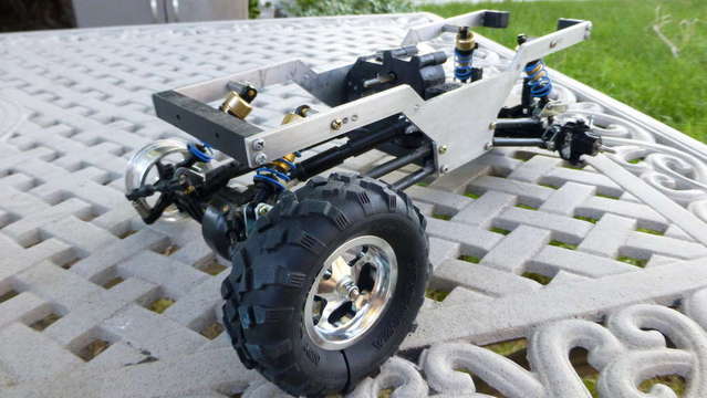

Making shorter links got it here:
Now it looks like iteration 2 of my VX with the 31"s I had:

The problem is the new shell is warped - u can see the rocker panel folding inward near the rear tire.
Any tips on how to get that to straighten out??
I wedged in some tools & let it sit for several days hoping it would help but it did not.
Looks like it's following the Zues nicely. As for your warped body on the other...you can try dipping the side into just boiled water(not boiling while you're dipping) for about 30 sec at a time and straighten by hand. Have cold water near by, and when it's where you want it, dip into the cold water to set it.
My 3D screen needs calibration. :roll:
Anyway... in the pic above you can spot a few of the previously mentioned misrepresentations in the shell.

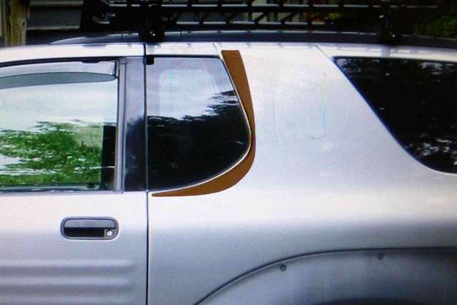

The C-pillar is shaped so wrong it has to be remedied.

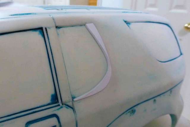

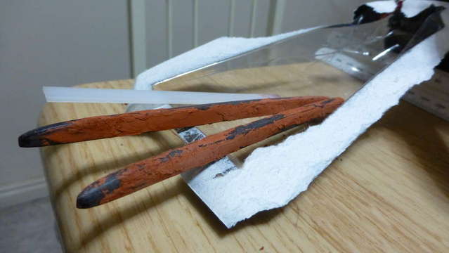

I used some paper to transfer the shape to some card material to cut that into a pattern and...
cue the styrene! .060" or 1.5mm to be exact:
Iz mo bedda!
Hobby scissors, Dremel, & hobby files got me here. Not too shabby, aye?
