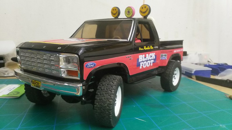

Here are some pics of my Black CR12 F-150. Raised the body mounts a little, moved the rear bumper in, turned the running boards upside down for more clearance and added the white Wagon Wheels and 1.55 tires. (Bought them used for $40) So far that is all that has been done.

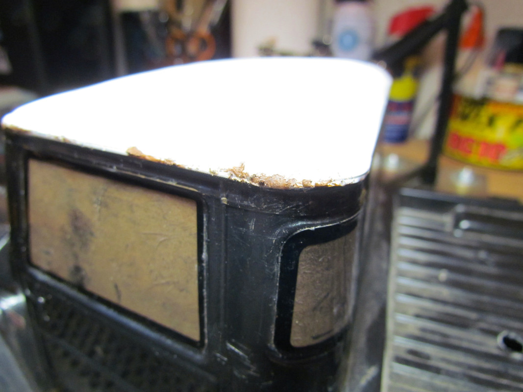

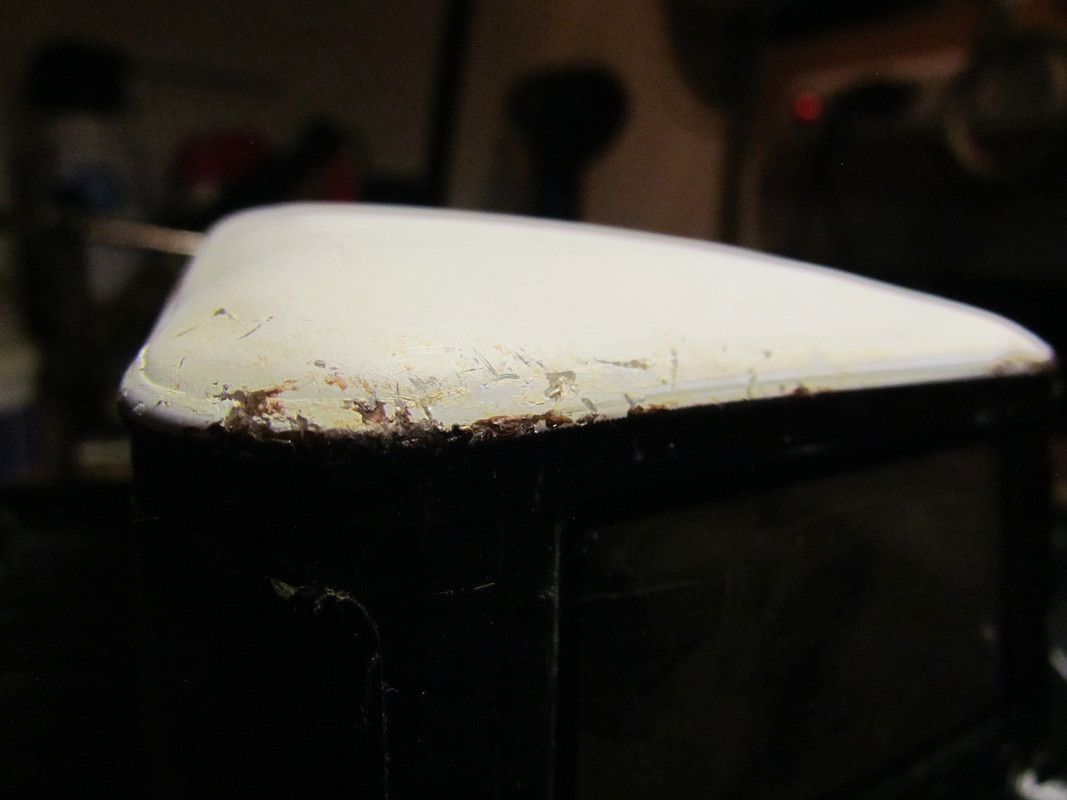

First up is the rust and dents. I used a lighter to create some very slight dents in the roof. Pretty self-explanatory- heat & push. I also went ahead and used a Dremel with a couple various attachments and some Krylon brown "flat protective enamel"... looks like primer. No color actually specified on the can. Sprayed out a little bit into the cap then applied it with toothpicks and micro hobby brush ( like a miniature q-tip). Not sure if I mentioned it already but I previously had sprayed the white roof with flat white on the outside. Anyway... came out really well imo considering it was my first time doing rust.

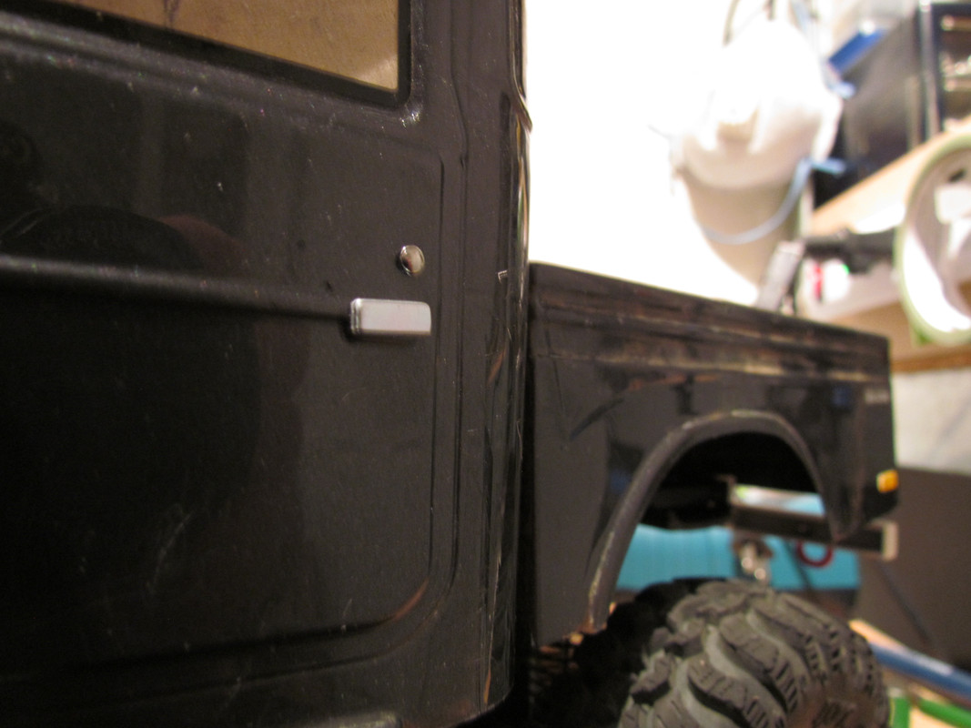

Added "door handles" and "locks" as well. Handles are aluminum using dbl-sided tape and for the locks I just drilled holes and used small nails, cut short on the inside and e6000'd into place.

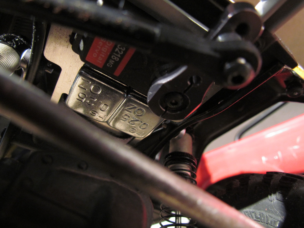

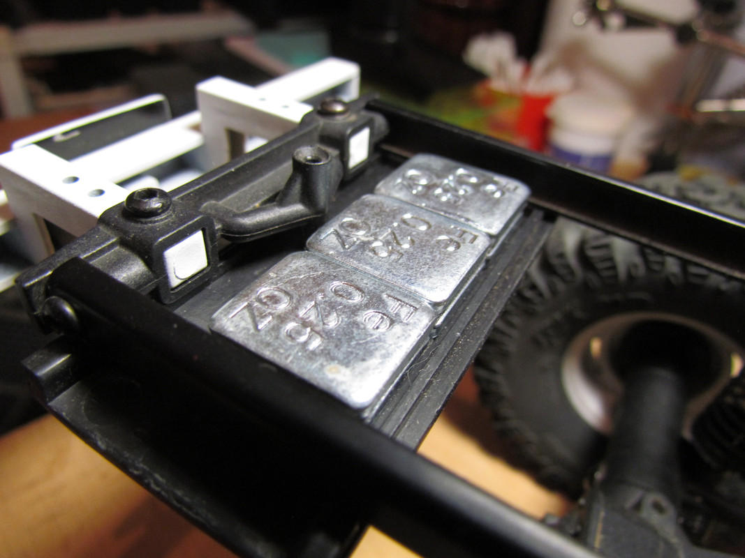

Next I wanted to add some weight to the little rig so I mounted 1 oz in the front under the battery/ esc tray... and in the rear I used 1 1/2 oz and used a cut/ modified old tx battery cover for the mounting plate. Stick-on wheel weights obviously.

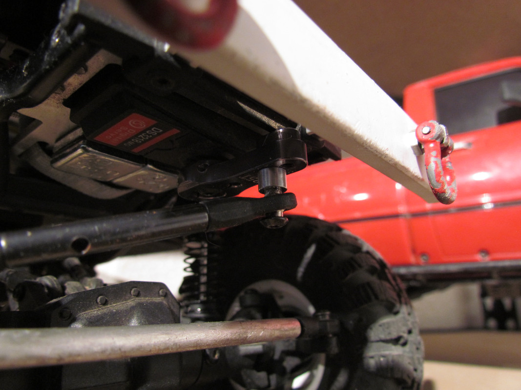

I also added a 1/4" spacer between the servo arm and the drag-link to put the drag-link more parallel with the tie-rod and reduce bump-steer. It worked although I may ultimately lower the servo... mounting it on the underside of the battery plate.

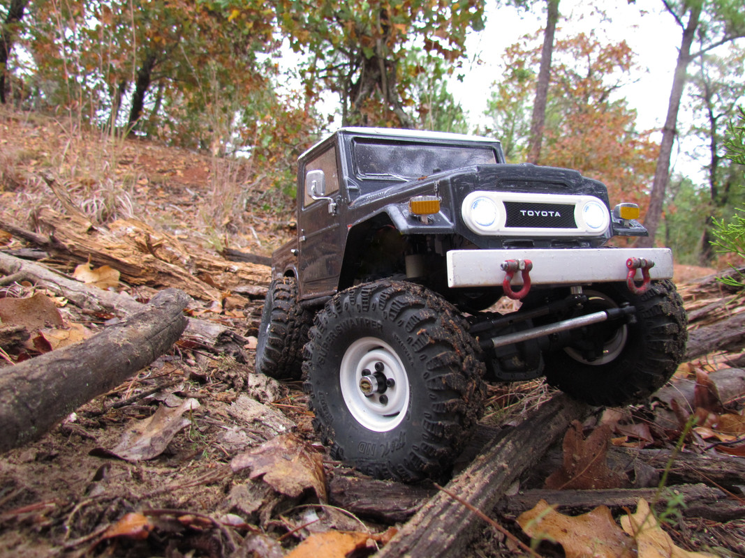

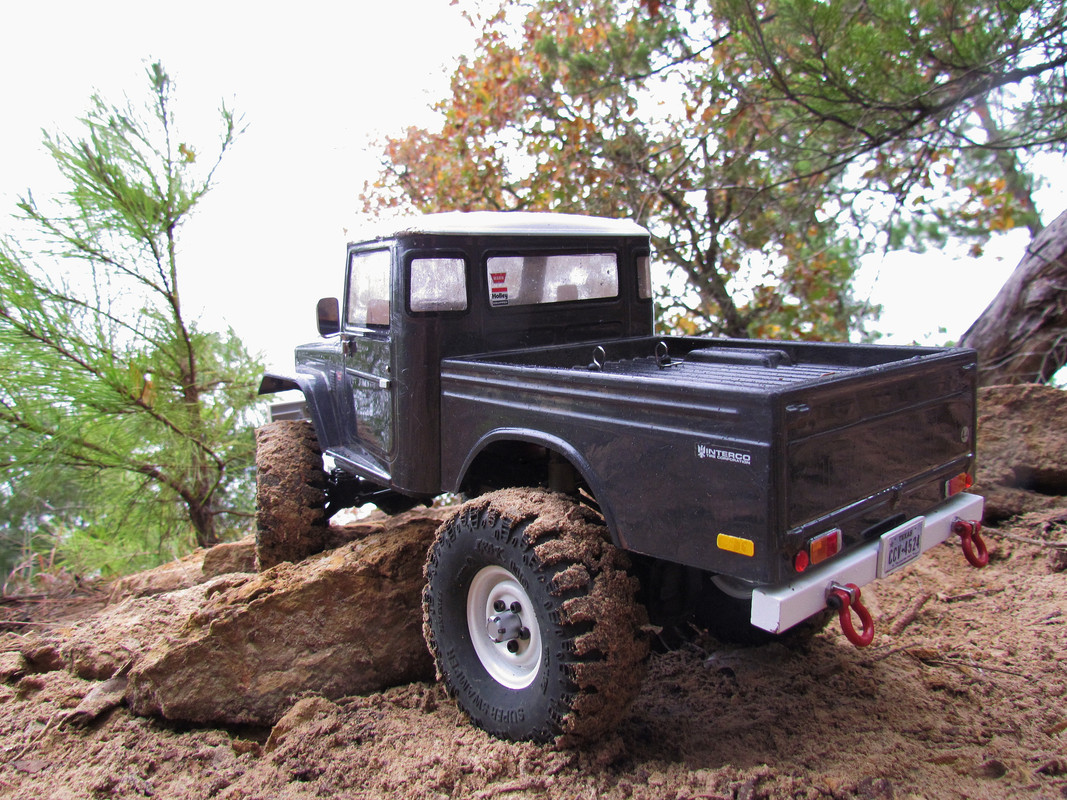

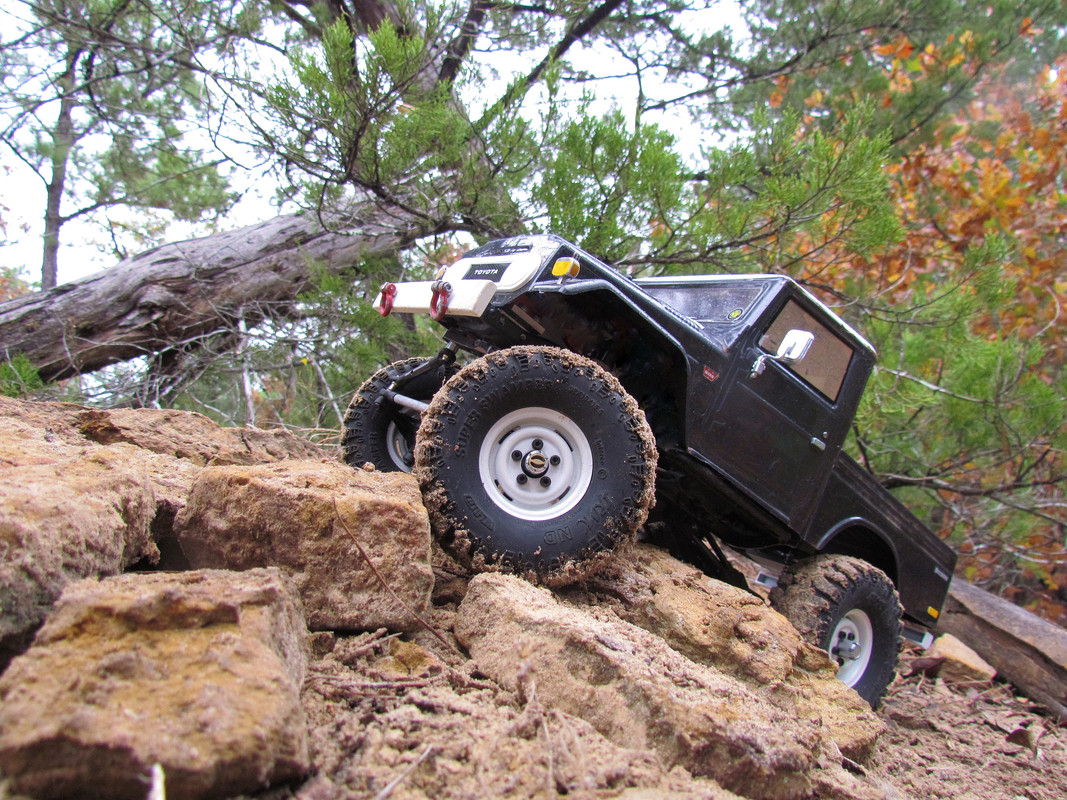

Finally... I just had to get her out on the trail! Super muddy, foggy, humid day but it was a good test and I have to continue praising this little beast. She is just such a capable crawler and so so much fun! Thanks for looking!

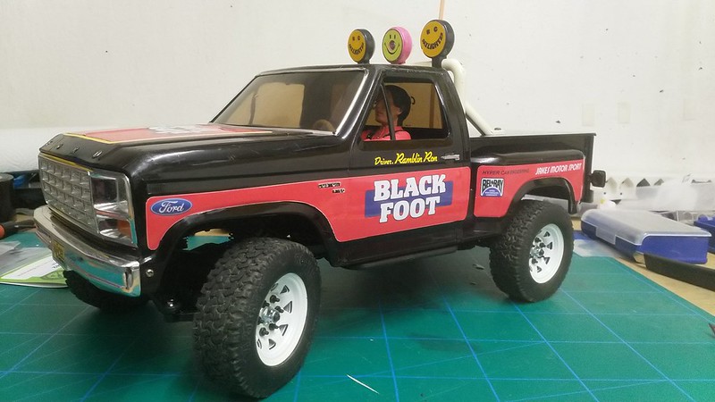

Saw a Thunder Tiger for about 90$ and could not resist to finally give my old Blackfoot a new home.
I'm not sure if this is a general CR12 topic. I hope it is fine to put some pictures in here
I got this Blackfoot about more then 25 years ago. Used it on the Blackfoot chassis for many years (my son was using it a couple times lately, just as I did) but decided to put in on the side. The body is rare and I did not want to completely destroy it at one point. This chassis is almost perfect and with some minor changes I was able to make it work.
I am not very happy with the stickers I bought on ebay. But they are good enough for now.

I've run mine quite a bit in sandy terrain. I'm guessing that due to how light the cr12 is, it partly why it does quite well. Obviously the tires play a part in that too but I'm always surprised that this rig is so capable in so many different conditions. Also worth noting that the sand that this rig typically sees isn't quite as fine and light as beach/ dune sand. It's generally a little damp and a bit heavier ( silica based).
