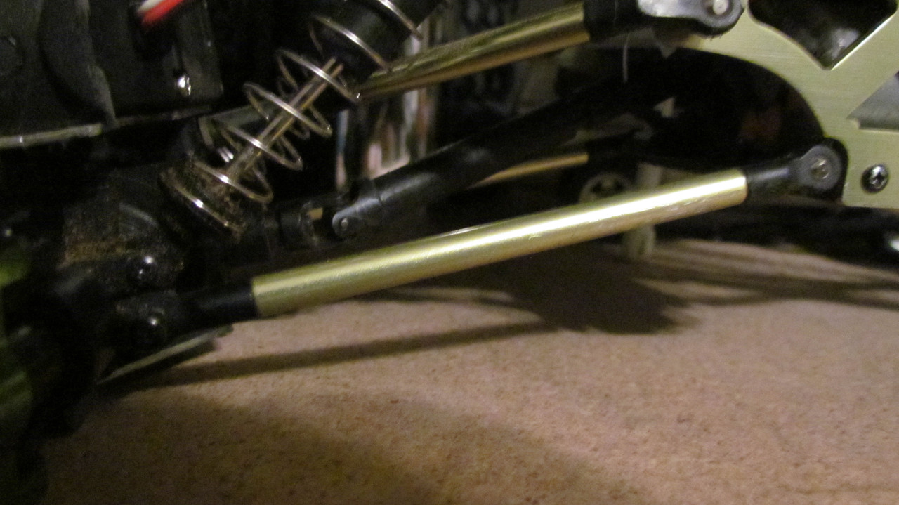

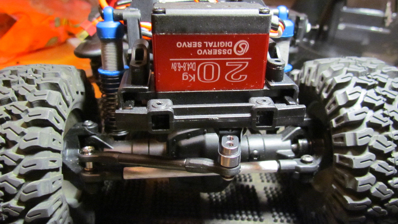

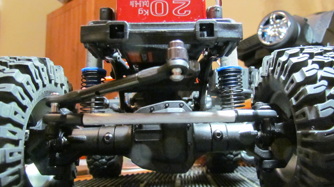

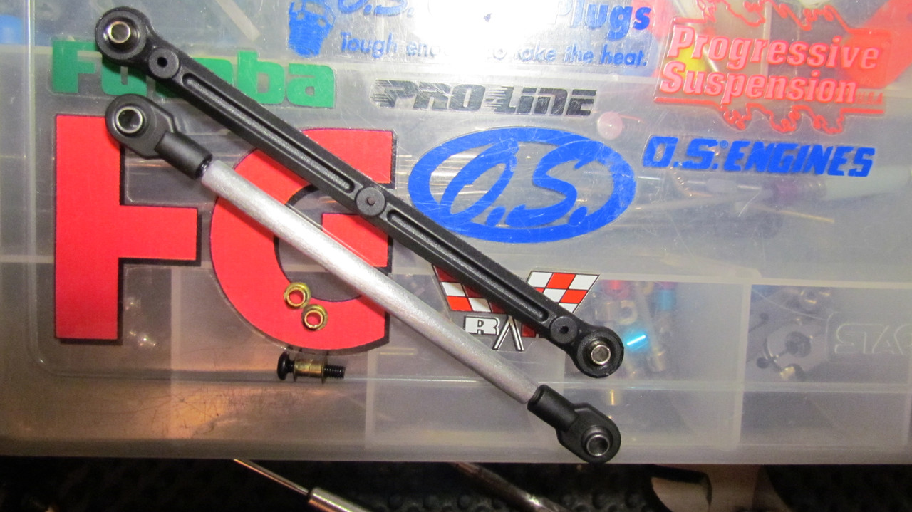

So decided to get going on the new tie-rod. Started going thru all my RC10GT and T-Maxx stuff and couldn't find any threaded links even close to the right size... everything too long/ too short. Then I looked thru my TRX4 and Stampede stuff and found a 78.13mm turnbuckle. Problem was that it was a tad too short to securely accommodate the approx 18mm rod ends that I wanted to use. I wouldn't have been able to fully thread the ends on and that bugged me.
So I took at look at my Exceed MaxStone 1/16 and there it was. I felt bad but since I'm not currently using the EMS, it had "DONER" written all over it. I removed one of the lower control-arms and it was a PERFECT fit!. Went ahead and unscrewed the plastic ends, removed the green anodizing, threaded the new beefy rod ends on, and popped in a pair of pivot-balls. The balls are a bit more robust than the ones that come with the CR12 which is obviously a good thing. Only issue that I had to remedy at that point, was a little play due to the [also] larger ID of the balls. So I found some brass inserts in my bin of servo horns/ linkages that wound up being exactly what I needed. They had to be shortened by a few millimeters in order to sit flush with the top and bottom of the pivot-balls but otherwise they were perfect. Hopefully I explained that sufficiently.

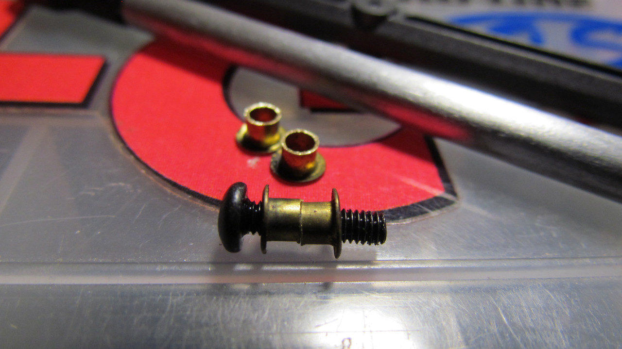

Pic of original plastic tie-rod next to the new aluminum one. Note the screw with the brass inserts that will "capture" the pivot-ball and subsequently allow the screw to fit snugly so that there will be no play in this part of the steering.

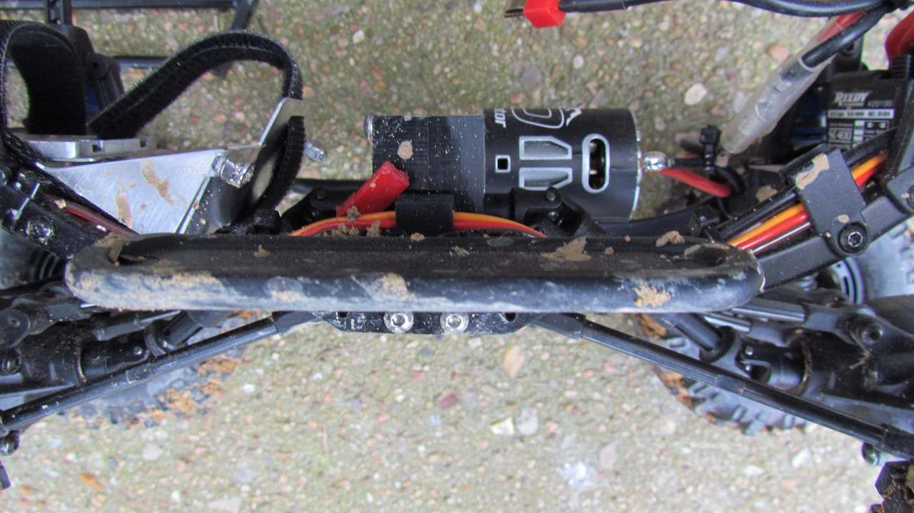

And a pic of the tie-rod when it was still a lower control arm on the EMS lol...
