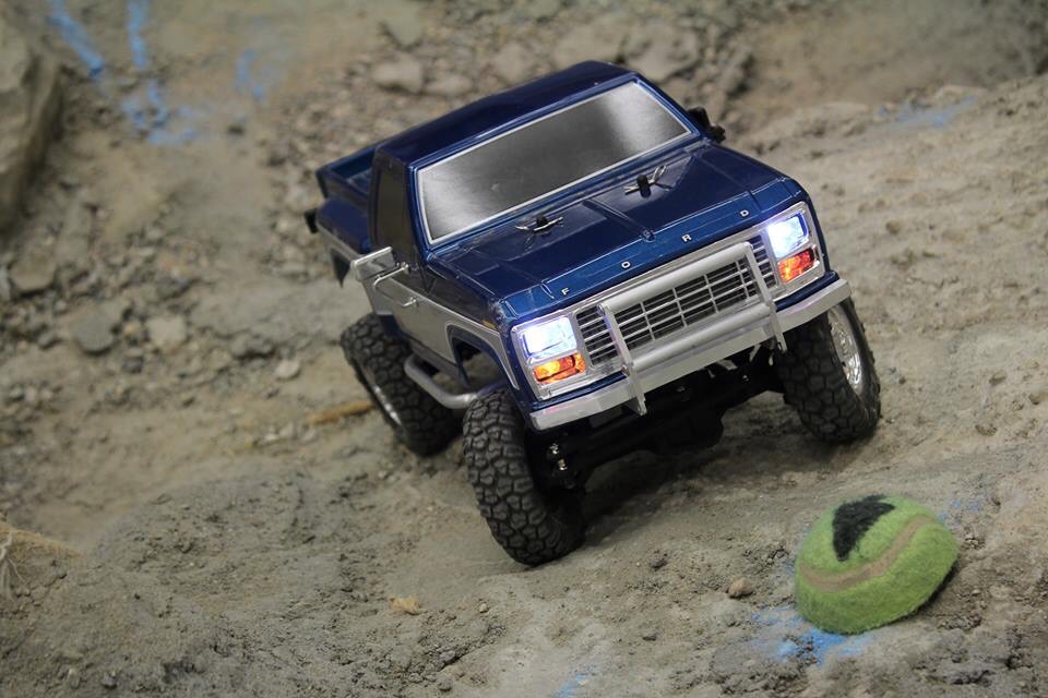

I read too. Got my wife one and have been tinkering with it and making 3D printed parts for it.
Put some bigger wheels/tires on it, which rubbed on the body, bumper and shocks when turning. I made some adjustable magnetic body posts, wider hexes and a new front piece to raise the bumper, so now no tire rub.
Bigger wheels made the steering geometry worse so made a combined piece to raise the servo and move it back a touch and keep the front bumper raise.
All in all she's happy with it and loves to trail with it alongside my Ascender K5.

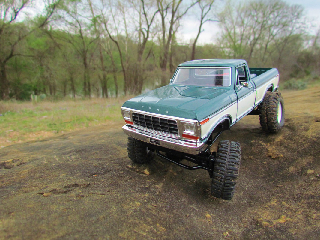

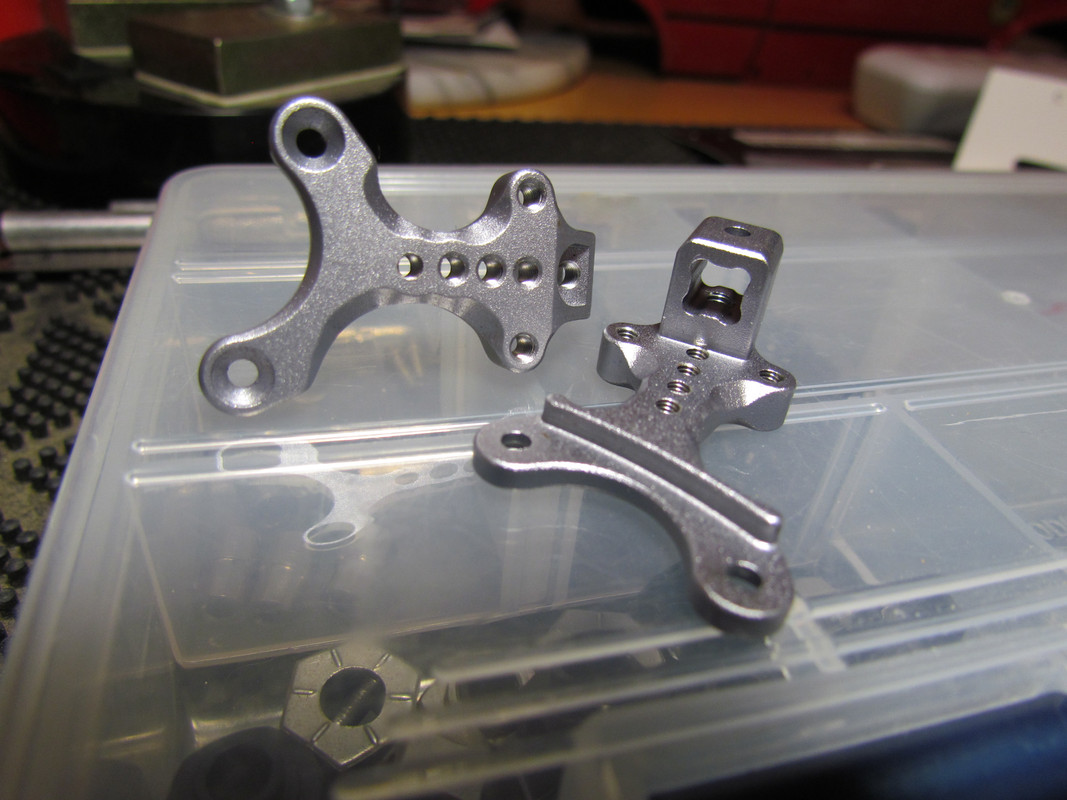

Picked up front & rear sets of GPM alum shock towers. I may mess around with a couple different shock mounting positions now that I can. Part# GPM KXS028F/R-GS

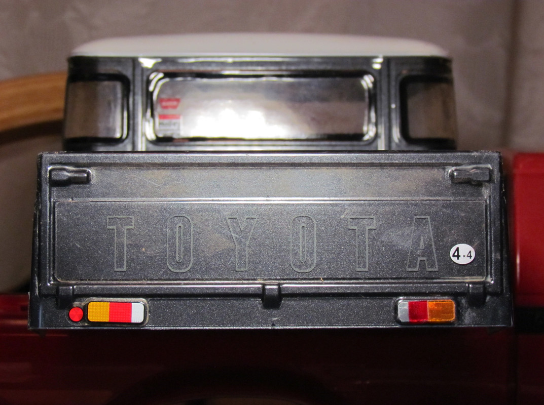

Also starting on the true reflectors. These are tough to cut yet necessary to cut precisely. Tedious detail work but hopefully the end result will be worth the effort. Stock decal taillight on drivers side/ upgraded reflective taillight on passenger side.
Yeah its an F150
Here's the servo and bumper mount fitted
Magnetic body posts fitted
Rear indicator stalks with brake, reverse and indicator lights. Still need to tidy the wires properly. Going to feed the wire through the body behind the stalk to hide them as much as possible.

Got the GPM aluminum shock towers installed. Fit & finish is absolutely perfect. I was going to paint 'em black but I like 'em okay as is. No pictures but I'm really happy with this mod as it really fortifies each corner nicely in conjunction with the upgraded aluminum shocks. I also made a faux fuel-filler to put in place of the decal and It'll work for now. I haven't finished changing out the f&r reflectors yet but I'll get back on that in the next week or so.

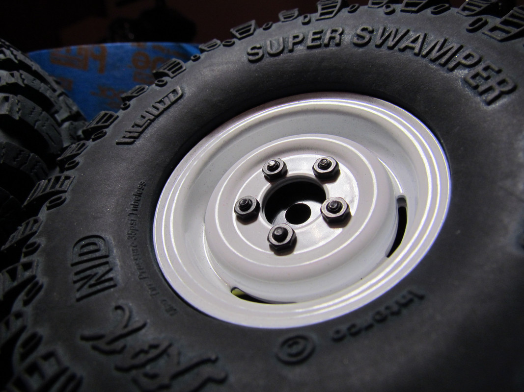

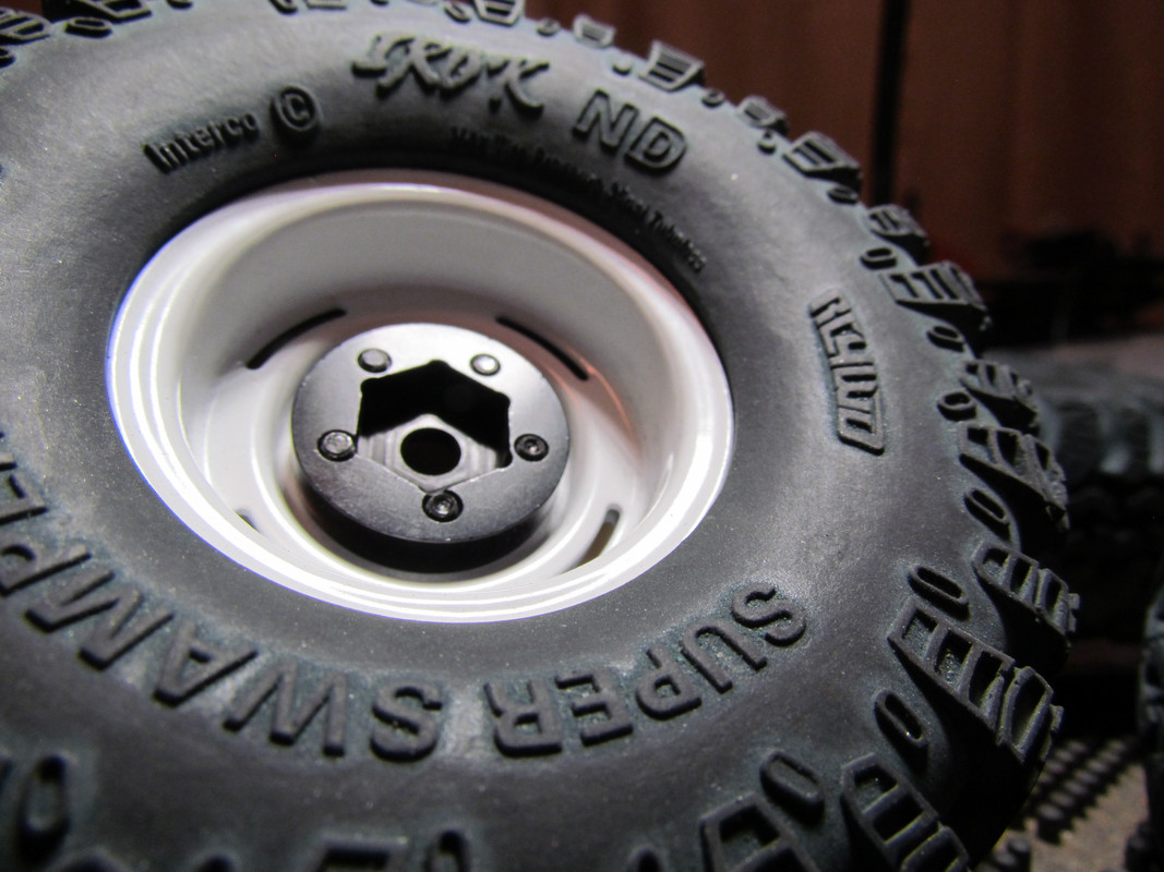

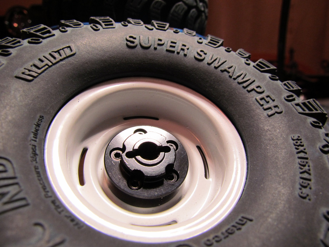

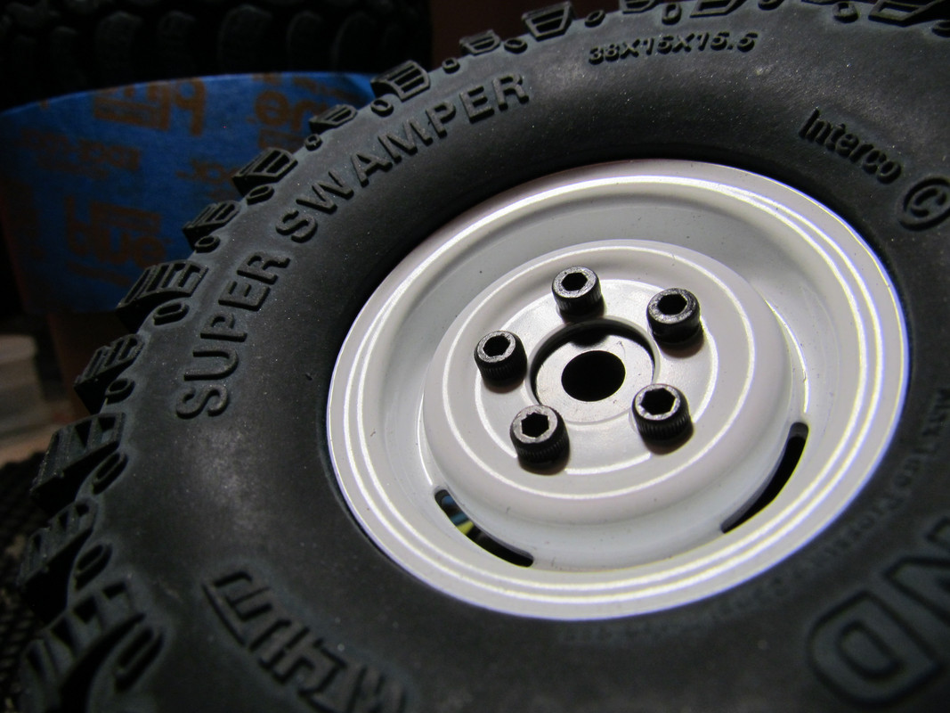

I was dead-set on using the vintage white Landie 1.55 wheels on the CR12. The look is exactly what I'm after for this truck and even though I ran into issues, I wasn't going to go down without a fight. One thing worth noting here is that these 5-lug vintage Landies are supposedly not going to be made any longer and they are already out of stock at RPP in 1.55 scale ( currently still avail for 1.9). I feel SO fortunate to have gotten a set before they were discontinued.
Okay... 1.55 issues:
> The 1.55" hardware is weak! Just snugging the bolts down, I managed to break one.
> The hex-nuts are visible from the outside and don't look at all scale.
> Also the hub is not threaded meaning that you must use the hex-nuts on the outside in order to secure the two wheel-halves together.
> The hub is a pin-drive and the offset causes the wheels to mount up much too close to the shocks meaning potential rubbing issues.
> The center hole is too small for the CR12 axle shafts. You can enlarge them but even using a couple washers/ spacers, the axle nut will not completely tighten down so the wheel wobbles on the shaft.
There may have been more issues too... can't remember atm lol, but that was enough for me to call it quits on using ( or even wanting to modify) these wheels with the supplied 1.55 pin-drive hubs. So I instead acquired some 1.9 5-lug hex-drive hubs.
New 1.9 issues:
> The center hole on these wheels is too small to accommodate the raised center section of the 1.9 hub.
> The wheel's lug-holes are too small to accommodate the larger diameter of the 1.9 hardware.
> The 5-lug 1.9 hubs obviously don't match the 5-lug 1.55 bolt pattern.
Enter the Dremel and the drill-press!
Enlarging the center hole was easy enough and not much material needed to be removed in order for the 1.9 hubs to fit flush against the inner wheel halve of the 1.55 with the raised part of the hub centered perfectly inside the center hole of the wheel. A Dremel equipped with an appropriately sized sanding wheel took care of this task pretty quick.
To enlarge each lug hole ( total of 40) I used a 3mm drill bit on the press in order to accommodate the larger bolts. This is where I ran into another issue and had to proceed cautiously. I wasn't willing to use any larger of a drill-bit because that would mean each lug-hole would be too close to the center hole... potentially compromising the strength of the metal between the lug-holes and the center hole. Ultimate disaster would've been ( during the process of drilling the holes or tightening the lugs) the metal tearing out... subsequently causing the lug holes to open into the center hole.
The solution was to find a Dremel grinding bit small enough to fit into the 3mm lug holes and elongate them outwards. I used a long thin diameter diamond engraving bit to do this and although it took some time to turn the 40 holes into 40 ellipsis, it worked lol! So now I have the 1.55 Landies and 1.9 hex-drive hubs all bolted up and fitting/ working flawlessly on the CR12 FJ!
Modified stronger 1.55 hybrid wheel...
Original problematic/ weaker 1.55 wheel...

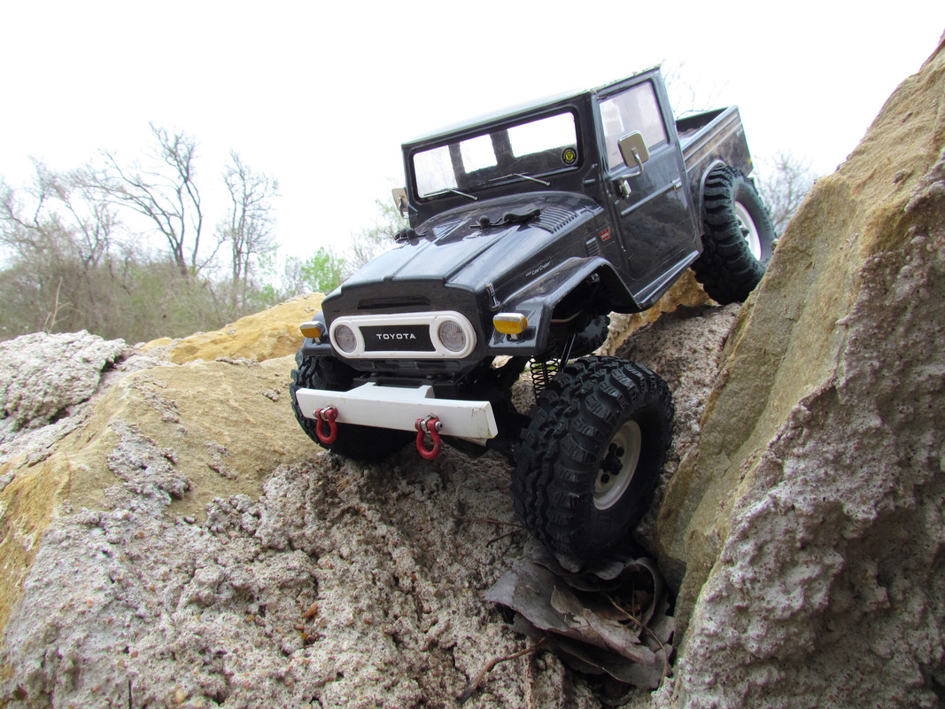

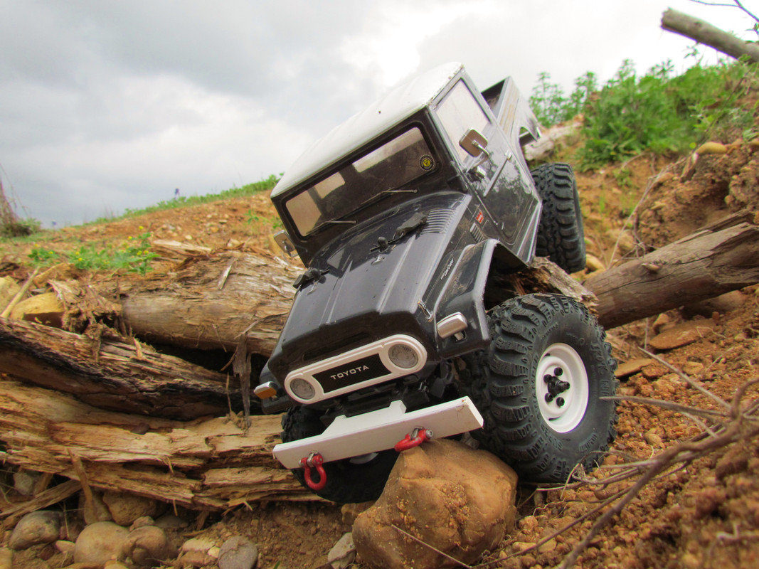

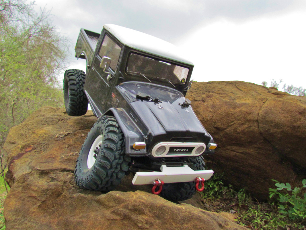

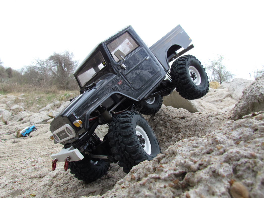

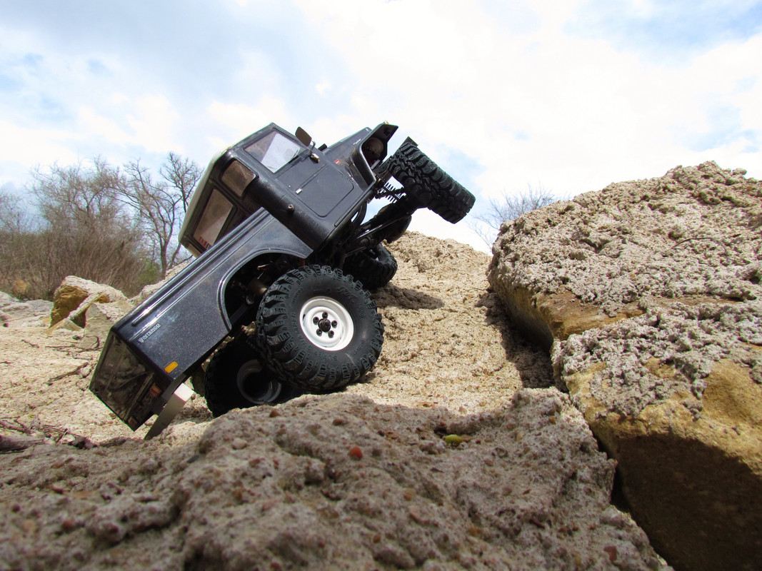

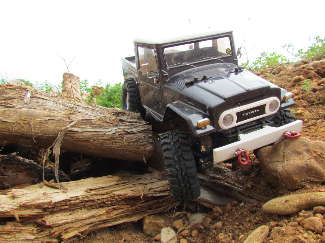

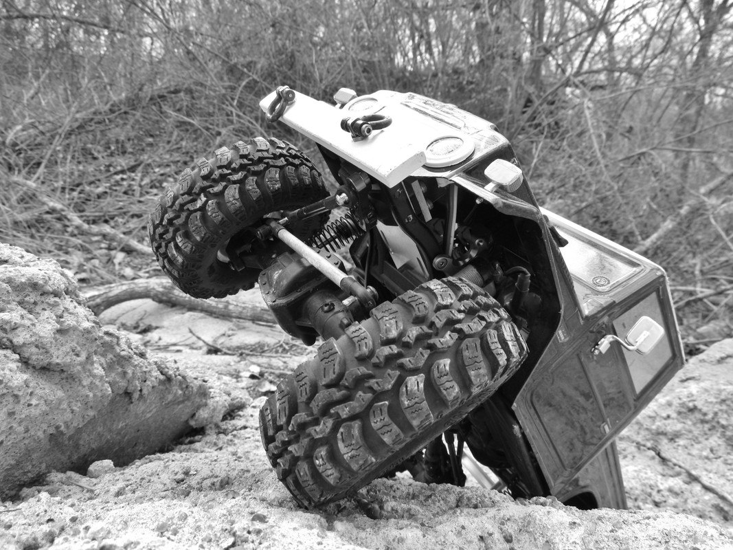

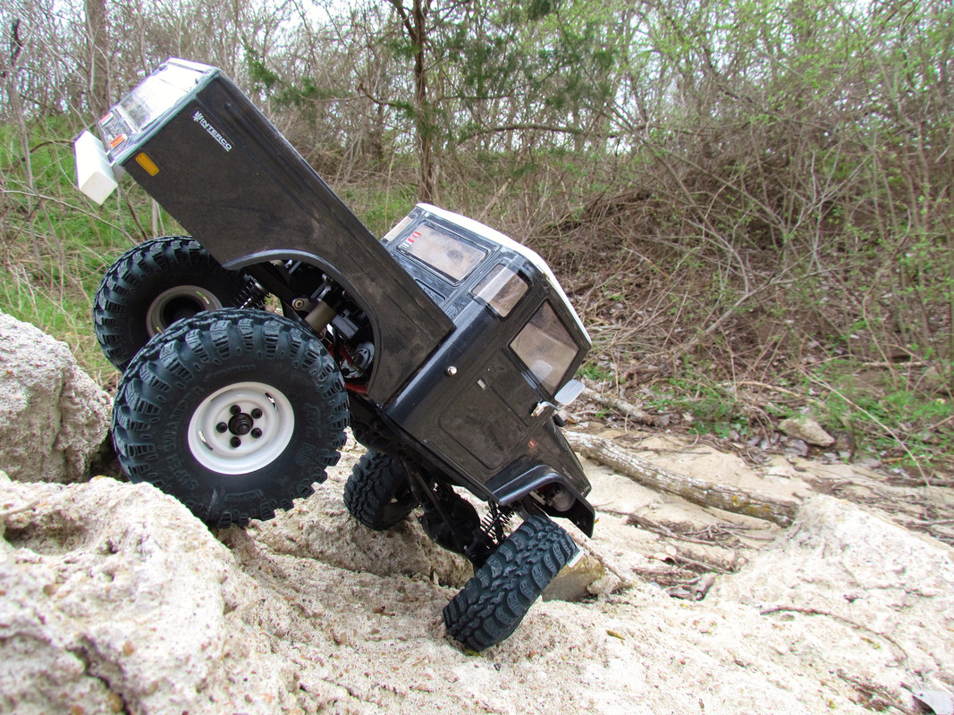

Now for some pics of today's action with the CR12! I'm absolutely in love with these wheels!! Tires hooked up like crazy on the rocks! The CR12 ran today with it's tiny little sister, the RC4WD Gelande 1/18... part of the day running a highly detailed Ford body and part of the day running the original D90 body. Couple pics of that rig in the next couple posts but mainly I was wanting some pics of the Associated with her new Landies. And as always... no poser pics!

Fwiw- GPM is making some really nice alum upgrade parts that are compatible with the CR12 even though they are listed for the Thunder Tiger/ Kaiser.
