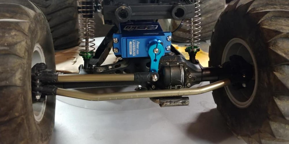

I got a set of HR 28mm 12mm hex adapters (which i for got to get a pic of BEFORE i installed them lol). Stock width i couldnt turn or rotate the suspension with the new PL brawler wheels n destroyer tires.
The front axle stubs had to be threaded into the extensions just a lil ways to get the drive pins thru the holes. They have a grub screw that threads in on one side of the extension to retain the drive pin. I used the washers included on the wheel screw to hopefully NOT pull one thru, like the axial m/t wheels i had on it.

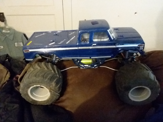

So for now, heres the newest pics. ENJOY! Let me know wat yall think...
Sent from my SM-J327VPP using Tapatalk
Truck looks great! It looks
W I D E! I'm sure it will handle better. What is the wheelbase on this truck BTW?
Sent from my LM-G710VM using Tapatalk
Thanks max! Im goina give her a go tomorrow. Hopefully she wont wanna roll so much. WB is 13.25 in, body wb is 12.3 in.

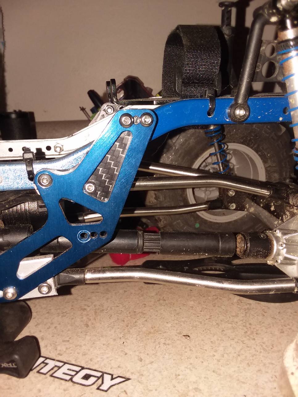

Hey yall, been doin some moddin today. Finally got some 3mm carbon fiber in the other day, so i figured today was as good a day as any to get dirty. My first thought for cuttin the CF was the lil saw blade for the dremel. Boy was i wrong, it smoothed the teeth off it lol. So cut-off discs it was, n they made pretty short work of it. Got them all roughly cut out n used a sandin tube to fine tune the edges. After drillin 2 of the holes, i put a couple bolts thru n drilled the other 2. I didnt think about it til after i drilled them, the 2 back ones were the only ones that needed the holes for the upper links. O well, theyre there if i decide i need to do the front too.
I got them mounted up n moved the upper links. Everything looked perfect... That is until i bottomed the shocks. The pinion rolled back way to far for my liking. So i found somethin to use for spacers on the lower links, the bushing for the spur gear on the old tmaxx/nitro stampede.
Now that ive moved the upper links, ive got all kind of room for a bigger motor. Now ive gotta find a new BL motor. I wanna b able to pull wheelies but still get a bit of speed too. To bad i cant wedge a erevo motor in there lol. Any suggestions on a new motor? Im runnin a mxl-6s esc on 4s.
Heres some pics, wat yall think?

U solved the issue i had before it was an issue for u lol. Your upper links are mounted up high, mine were mounted more level. Where they mounted to the chassis limited my motor size. After brainstormin with my buddy briber, we come up with the idea for the carbon fiber plates i made. They let me move my upper links higher to make room for a bigger motor. Which is a tight fit lol. The wires comin out of the motor are barely touchin the nut for the upper link now. Theyre to stiff to move them. N if i try to use the other mountin holes in the motor, it just puts the wires to the other side if the frame. Its not an issue, so im not to worried bout movin them. Cant wait til monday, goina take it to work with me n ger her a rip with the new motor

Had to get new knuckles for the m/t. The stock ones broke at the screws at the steering arm. Got a set of blue VP knucks, sorry didnt get pics before i put wheels on.
Also got a set of HR sway bars. Helped tremendously! Very little torque twist now, which put all the pressure elsewhere... the driveshafts smh. So looks like its time to upgrade the wb8 driveshafts. Any suggestions?

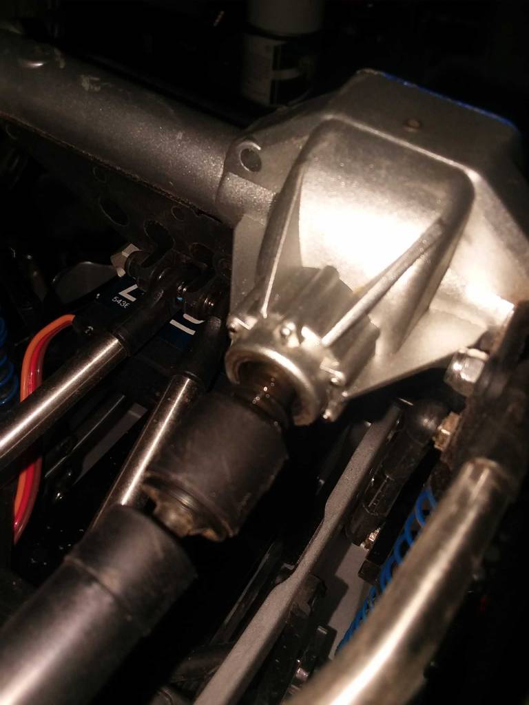

Got the bearings replaced in the front axle. It granaded both pinion bearings in the front. Took me a bit to get the outter race out of the housing. Had a few bbs in the housing n some shavings, but nothin to major. R&p looked good, no nicks or missin teeth.

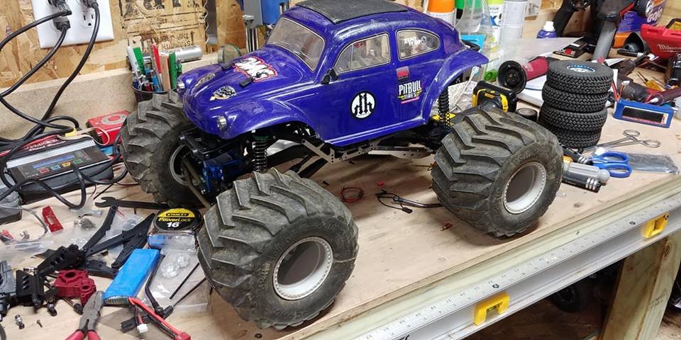

Holy crap, its been almost 3 yrs since i posted here. I ended up tearing this truck down, it kept spinnin the hexes in the wheels. Thankfully it didnt ruin the wheel hexes. Ive thought about this build a bit lately n wanted to revisit it.
So as yall probably know, horizon had a big spring sale this week. Well i broke n picked up a smt kit for $100, wat a deal! My plan is to recreate this old truck, with some better ideas. I won a set of ar60 beef tubes in the raffle at scale nats 2 weeks ago. The question is, do i run the stock plastic housings n grab another set of beef tubes? Or do i pick up another set of aluminum housings like i had before? Definantly wanna get another HR big hit servo saver like i had before. Another thing to take into consideration is the chassis. I want the old school m/t look again, so im thinkin use the scx chassis with the ax tvp setup. Or should i use the cage n just cut the rear angled tubes off?
Then we're on to electronics... Ive got a CC mmx n i think i may still have the traxxas mxl6 esc yet. Ive got a few BL motors layin around i could try as well.
Any n all suggestions are welcome fellas. Thanks for checkin this thread out again, ill post pics up later on
I got my cheap SMT kit yesterday. I say kept the SMT chassis and modify as needed, no need to go back to SCX and AX TVPs unless you want RC nostalgia.
I’m debating Fling King Jrs on the stock wheels or going with the 2.6” monster truck wheels and tires.
