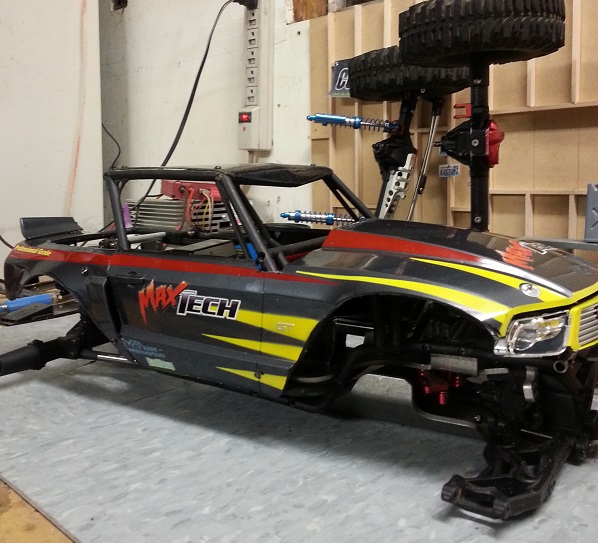

Well it took me long enough to finish this build but it is finally done. IFS and twin shock trailing arms and a 3600kv short course motor on 3s powering it.
And of course, a series of pictures wouldn't be complete without...
After getting all the shocks tuned in and ride heights set, it now jumps like a champion and flys like an arrow. You sir, are a magician.
A little bit of powder coating never hurt anything.
Still trying to figure out the hubs with MIP shafts though.
