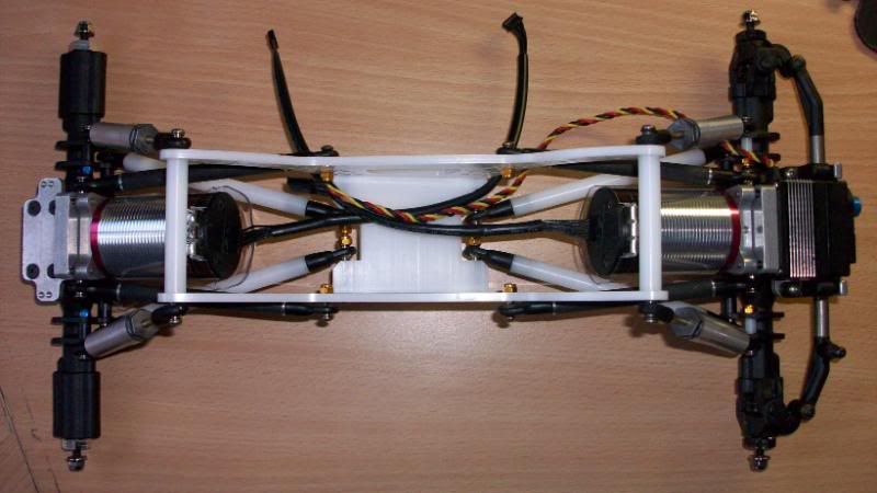

Time to build my very first MOA! "thumbsup"
And here we go.. i like my losi and wanted to stay losi so its losi based:mrgreen:
When it come to chassis i went with a BLC Chopper chassis, its got a really nice shape to it and the fact its made for the losi is even more reason...
And the electrics, Tekin RS esc's and the 17.5t brushless motors with the 13mm high torque rotors
I had to weigh them lol, i only used half the motor wire, the bit i cut off weighed 13g so they are great for keeping weight down if going brushless
Heres the high torque rotor (bottom) and stock (top)
Ive never pulled one of these apart before and thought there might be a few people in the same boat so i took some pics..
It was supper easy! after removing the ends stuck it in the mini vice and pulled it out..
When fitting the new one the vice made it easy to line up..
Next i stuck the BLC regears in the lathe and took 1mm off them to gain extra clearance from the pinion grub screw and aid in pulling them off to clean/regrease in the future..
Before/after
Nice and easy to get off without removing anything..
Mounted
Axles together..
I made some skids out of lexen card with a heat gun and a piece of delrin behind the axle..
Mounted on the chopper..
Ive been using titanium & alloy screws with alloy nuts to keep weight down in this build too...
I used the losi battery mount to mount the battery in this...
But needed a diet first hehe..
A pic of it all fitted, i used the stock losi rear esc mounting tray to mount the nomadio receiver just cut down and lightened but forgot to get a pic :mrgreen:
Now one thing ive been very keen to find out is how it compares to the losi weight wise... and to say the least im very surprised :mrgreen:
My losi as it stands - batt/wheels/lid... 1108g
The chopper... 1214g
Rear axle losi.. 513g
Chopper... 538g (not the big difference i was expecting)
Front losi... 580g
Chopper... 638g
You may of noticed by now but i'll post anyway... The shocks i used are the losi ones i lathed down like my LCC and to suit the chassis i did the rod end mod to them to gain a little height as im using semi droop f&r...
Just a few comparison pic of the two...
And the chopper with lid... 1280g
Theres more to come when parts arrive, ive got more stuff to bring the weight of both rigs down some more, ive got RCBros high clearance knuckles and new steering linkages... for now its running (thats after it took me 5hours to find a fault in my wiring! a BIG thanks to Linc for his help!!) and i plan to test it tomorrow
