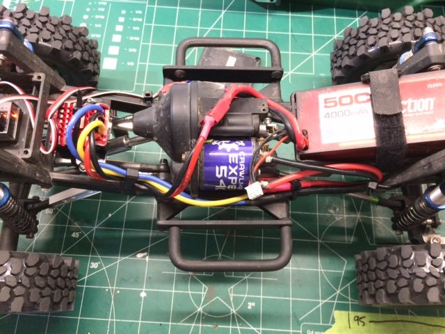

3s / HH 13T CM @6.0v / spektrum 6230 servo. No hold on the incline and under full load the steering servo would glitch and cause tire movement.
Switched to 2S all the same settings and it holds / no servo glitch.

My second one showed up so I threw it in my TF2 with a Holmes Torquemaster Expert 35T and went for a little rip. I am very happy with this ESC! No issues whatsoever, never got hot, wiring is so much cleaner without needing a BEC (have a Holmes HV500 in this rig), the only thing is there's still a beep when I thought it'd be silent. Might try playing with settings to see if I can help it. It's quieter than my SV3 was but not as silent as a Holmes BRXL.
Should be able to eliminate the slight high frequency beeping by switching motor drive frequency setting, let us know how it goes.

I changed the PWM Frequency (Setting #13) to 16K (Option 5) and the truck is now essentially silent. The electrical noise/beep is extremely faint now, where I have to get close to actually hear it. Extremely happy! Paired with my Holmes HV500 servo I don't have any electronics noise anymore, which makes a huge difference when running it. Way more relaxing! Way to go Hobbywing, what a great product!!
