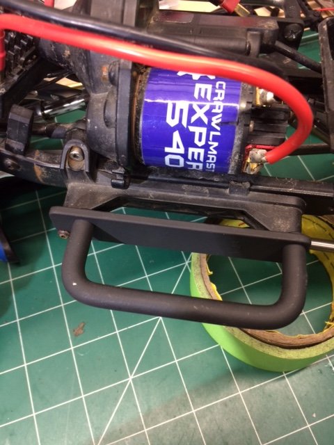

My order arrived this am and 2 1080 WP are in. Nice and compact compared to the SW3. Finally had some "quiet" time this evening to install / solder Deans plugs etc. Sunday I will read up on the setting's.
The 1080's will be going on a Vaterra Ascender and a TF2, both running HH Crawlmaster Expert 13T w/ 3S.
