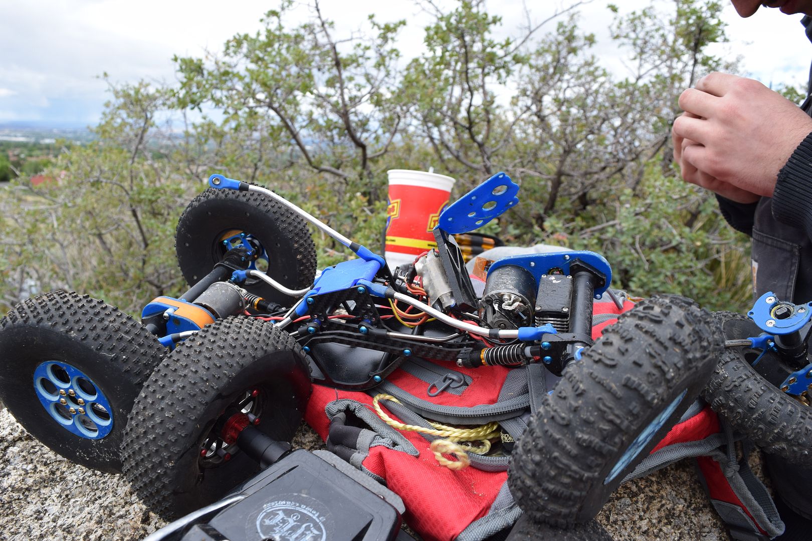

And then my little bit of popping.. Turned into a lot of popping. Field repairs!!
And that's about where my day ended. I started the last courses so I didn't get a +50.. By far my worst comp ever. But Owell, it is fixed now, and I a, ready to rock for AZ. We had our season closer this past weekend.. When those pics surface I will post them.
