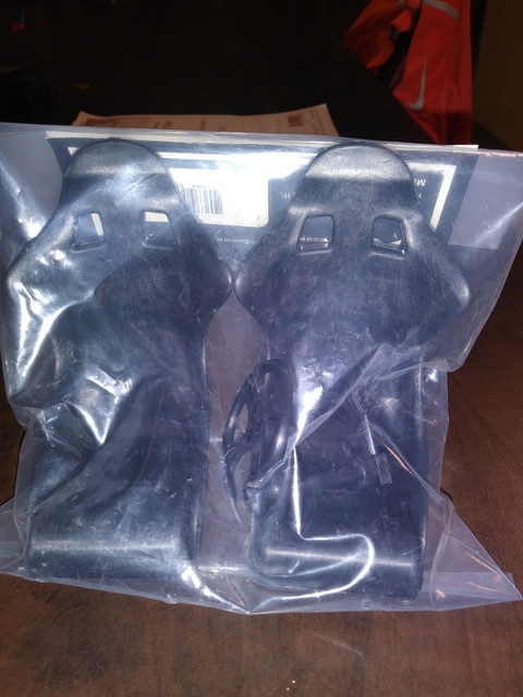

GOM interior details are in. It includes two race type seats, two shifters, and a race type steering wheel. Good value for around $15 shipped.

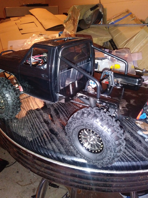

Remember this the gom interior and fitment with the cab.
Well this happened.
It sits a little high as you can see in exhibit B. And part of the passenger floor hits the intermediate shaft.
Just getting a feel for leg room and such
OVERTIME
He didn't did he?
Sure I did. Need a little bit more work. Like frame mounts but you get the idea. Also going to space the rear bumper out so its not hidden.

Just one rear wheel will drop it back down. It close to 50/50 maybe 55/45 weight bias so far.
And I have the flatbed mounted now.
