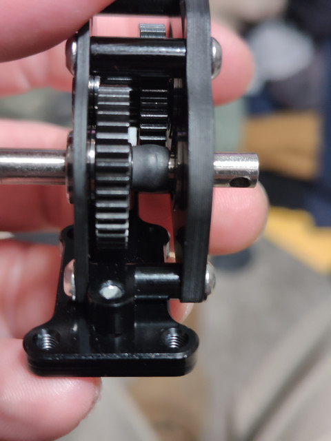

Installed the new side skids. found and installed the artful dodgers ULV trans. Didn't realize that the outputs should be to the outside holes and not the center. Wish I realized that when I was swapping to the left hand motor plate. I'll fix it later when I install the motor I haven't decided on yet lol

I swapped the outputs on the artful dodgers ULV transmission and was getting an slop/gear bind after doing so. With the tolerances I was racking my brain to come up with a spacer to help. A tiny O-ring was digging into other gears. Then found some shrink and made a spacer with that. It has worked so far let's see after I add power to it.

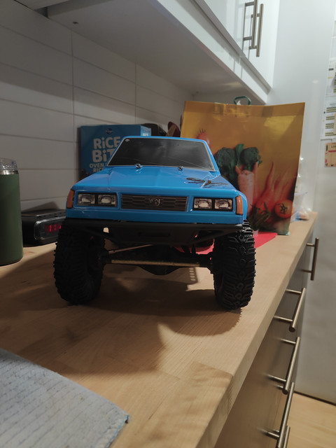

Project "birthday brat"
Started out as a scx10 I bought from a buddy. Esc and servo worked but no go. Ended up being a broken motor wire.
This project is my son's birthday present which is new year's day.
It somewhat of a parts bin rig. Since only thing I bought for this truck was the rear bumper mount needed one that was extended. The brat body I bought for the IFS mullet but some to big. I used the rear rock pirates shock towers I did buy for this rig but when I had different plans for it. I had an extra set of Amazon body mounts which help get the back level and lower to the frame. Tossed on the pinseeker tires from the SE still on element plastic beadlocks. Vs410 origin front bumper. Most likely use the rear bumper when I find it. I remember it fitting the body well. I replaced the motor with a 35T rc4wd I've had and never did anything with. I moved the battery tray up front and electronics box to the back. To help with weight balancing.
Still need to paint it but have most of next week off. So I'll get to it. He wanted a light blue in color so I had him pick one out.

Finally got to paint "birthday brat" in Tamiya PS3 light blue backed with Traxxas black. First paint job I've done in a while I think it turned out great. Son has already saw it and loves it which is what matters.
I found the rear vs410 bumper and I got to say they fit this charisma brat very well and tuck nicely. I have some element side skids I might swap on or at least try them haven't decided yet maybe down the road.
Well it's 100% complete and ready to gift. I did install my old element SE side skids and the fit great. Hold the body and the sliders look better probably cause they are clean and not used. But I have all the electronics mounted. Definitely going with a different battery mount that hard case 5000mah is huge in the nose. Lol
