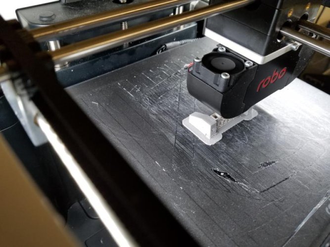

I am at this very moment printing a servo mount that I hope will mount the servo as close to horizontal as possible on the front crossmember.

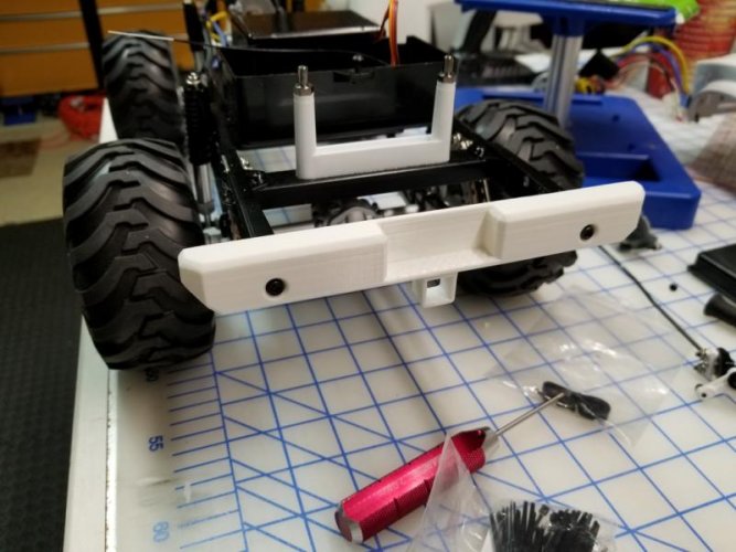

Removed oversized bumpers, printed a new rear bumper.
Removed goofy @$$ half cab and got a Mountaineer rear window off ebay.
Sketched up and printed a roll bar to replace goofy @$$ half cab.
