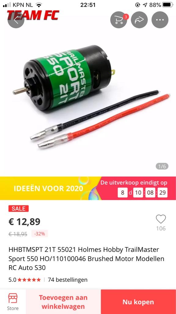

Fake holmes hobbies motors?
Hi guys,
I purchased two hh trailmaster 550 sport motors off ebay.
They look pretty legit however they don't seem to have a bearing in the output of the shaft.
Looks like a bushing to me.
The package also had dark green logo not black.
Has any one heard of this before?
And the packaging for the motor should have black printing yeah?

Was it a legit seller or something like "FlyByNightChinaSales"?
I was curious so I started poking around on Ebay -- I don't know if this is the same seller, but Holmes Hobbies motors shipping directly from Hong Kong seems a bit strange.
https://www.ebay.com/itm/27T-55021-...116979&hash=item2ad7d18e7b:g:86kAAOSwq15ds~X6
All over AliExpress too...
