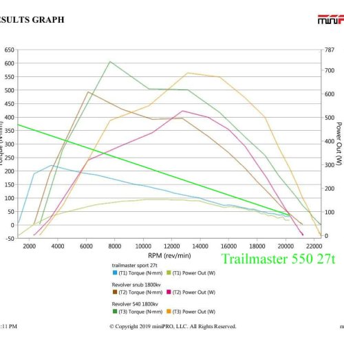

Hey John. I have a Trailmaster Sport 21 turn 550 in my Axial UMG10. I’d like to put one of your 1800kv Revolver motors in it. How does the power of both Revolvers (regular and snub nose) compare to the Trailmaster that I have. I’m not searching for any more power since I’m more than happy as far as that goes, and the price of the 2 Revolvers isn’t a factor, so if the snub nose is as powerful/more powerful than what I have I’d probably go that route. Thanks!
Voodoo, thanks for that graphic! Man those little suckers make some power! Guess I’ll be more than fine putting the snub nose in my UMG10. It’s all stock with the exception of aluminum beadlocks. But I’m also thinking of putting a standard Revolver in my TRX4 Tactical. Similar scenario but I shed over a pound off of the body removing the inner fenders/spare tire and other doo dads off of the back, removed the locking/unlocking diffs and servos and put spools in, but left the 2 speed so thinking a standard in there. Enough rambling, and thank you again for the info. Helped me a bunch.
The bigger ones have the benefit of more surface area to dissipate heat better. All that power will probably create heat...I don't hear about them overheating often, and gearing down can stop the heat as well.
