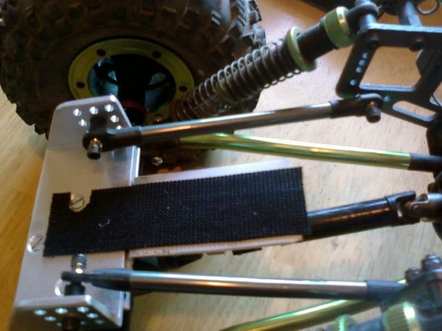

These are pics of my links now. I spread the front uppers but still need to make a brace for the shock/lower link like Creeperbob did. So far I'm stoked with the Creeper! ( and a pic of my most recent bike in progress- I use a kiddie trailer to haul my trucks around, I get alot of looks on my 6' long custom frame pulling my toys!)

[ QUOTE] These are pics of my links now. I spread the front uppers but still need to make a brace for the shock/lower link like Creeperbob did. So far I'm stoked with the Creeper! [/QUOTE]
GLAD YA GOT IT WORKING MORE TO YOUR LIKING, THAT LINK / SHOCK SUPPORT IS THOMAS' IDEA I STOLE :mrgreen:.
AND COOL BIKE"thumbsup"
Very gracious of you to recognize the originator of the link support Bob! LOL. I think I'll use some aluminum since there isnt much room for two rod ends but for now with the lower link in the stock posistion I think I'm okay but I do want to move the lower link inboard to get rid of tire rub. I cant keep my eyes off the vulture chasiss! Only draw back is my impatience with the mail! RMDW seems to be having some difficulty with them and I dont like waiting a month for something I can make myself, if I had the time! Cutting aluminum with the tools I have on hand takes for ever! I do have a plasma cutter though but steel is so dang heavy. Wheels are a turnin

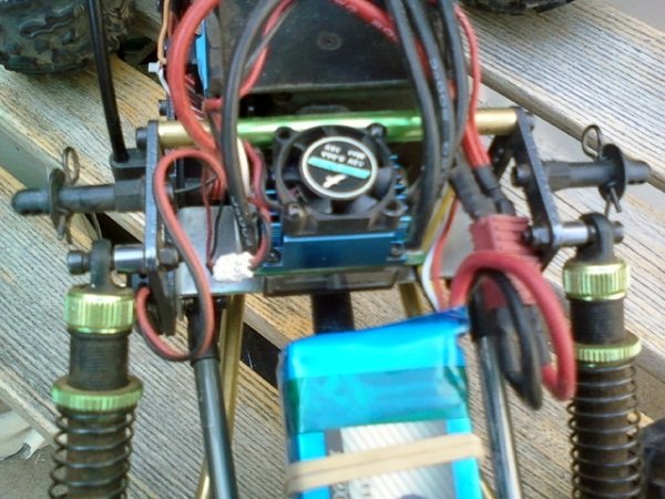

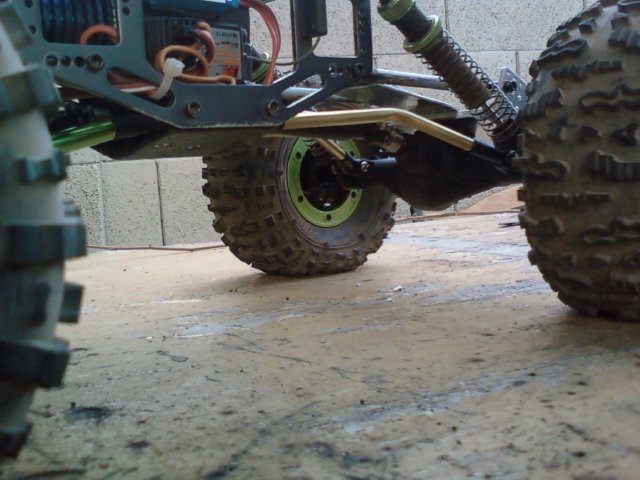

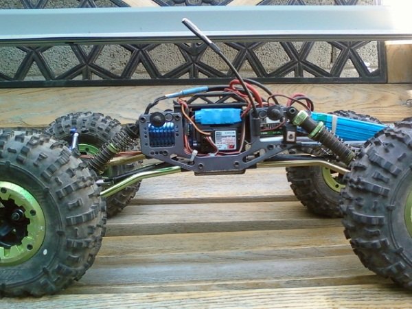

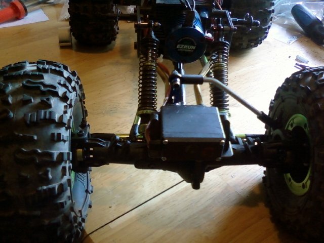

I've gotten some work done on the creeper. Made new rear lower links- reversed the fronts, made support pieces for inboarding the front lower links and shocks, did a BTA steering set up, and made a new mount for the speed control which also serves as another chassis support. I think I might need a little more weight in the front now though with the speed control being relocated. I saw someone use washers inside the bead lock ring- think I will try that. I dont know how much weight i have now but I use strips or lead wraped around the wheel. Great stuff from lead backed drywall for x ray rooms! I hope to get out tomorrow and see how the changes affect it since I worked my self out of work! lol some play time is in order!

bluenose....in general it looks good. I'm sorta ":shock:" on your servo to knuckle angles....... Could you flip the servo arm and get a lesser angle from the servo to the knuckle??
I understand you need to clear the front shock.....but......wow.
Maybe my son, asw27x, will chime in later. I'm still a n00b in crawlers...8)
