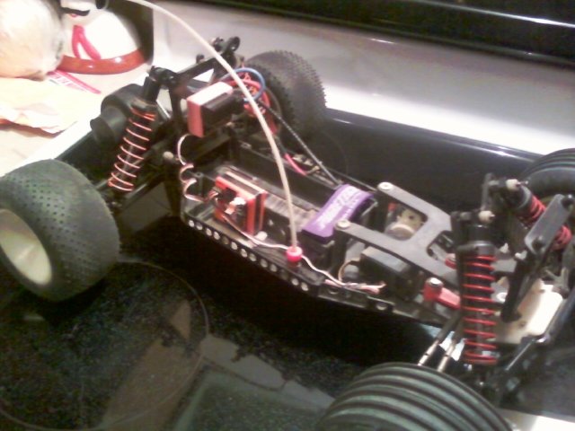

Its old school- I really cant remember the exact name of it but its when Losi came out with the hydra drive slipper clutch. I got the truck back in the early 90's but I've still found parts for it and its still competiive- 3 yrs ago I raced it here at srs speedway and took 2nd in stock 2wd truck. Funny because only maybe 3 people there had any idea of what it was- needless to say they had grey hair also! lol. Its a keeper if for nothing but nostalgia- sits in the closet with my losi XXT- the old 4 link race truck. Here's a pic- I stil have near new race tires too! Maybe someday it'll come back to race again.

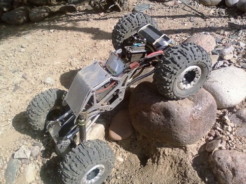

Got the chassis on today. I am liking the way the truck looks and cant wait to get it out on the rocks. I used stock lower links for the rear uppers and had to shorten up some old rear lowers I had made for the front uppers but all seems to be working good on the bench. My only concern is I'm going to have to be more careful when the truck tumbles with the steering servo so exposed and the same with the rear shocks. Might just be my imagination but the trucks overall weight seems to be a bit less. Also plan to take all the anodizing off and do some trim work on the BTL plate since I dont run my battery up front and it gets caught up on the rocks at times, but makes a convienent place to experiment with weight.

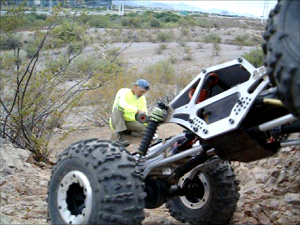

I have missed all the comps so far this season dealing with family issues and I have only had the chance to run the new chassis for a couple packs but so far I'm liking it alot. Had to get the front upper links higher on the chassis to help with the TT and its doing better. Biggest problem now is the shocks. Think I need some Losi shocks or steal some from MR Tmaxx. The stock shocks are just to long and I cant get the ride height I want. I took a couple pics out of a video to show but they dont seem to be loading correctly? I will get some more maybe today- think I can talk my 6yr old daughter into a quick trip to the park.

So I got one pic today- my daughter took up all my time flippin the jeep over! So cool that she is starting to understand Dads passion! "Try to follow me dad" 3s on a 27turn ! ya right the creeper is a creeeper!

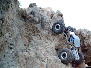

So its been a long while since I posted on my Creeper. Fractured my ankle in four different places in December but I'm walking again now- slowly-very slowly but able to get the rig out. Got some losi shocks on her and got some 3s 1300 lipos and the truck is running really well. Cant believe how much better it is with the losi shocks- finally able to get the ride height I wanted and they are so much smoother than stock. The smaller lipos fit much better up front compared to my 2200's and still give me about 45 mins run time per pack. After reading some on Creeperbobs thread I got my front steering knuckles to a slightly negative angle and it really helps out with the torque twist and makes it "feel" more stable. I hope to make it to a comp soon- the truck is ready, am I?
This is a quick clip from yesterday- we crawled for four hours but I forgot to take more video-to much fun driving again!

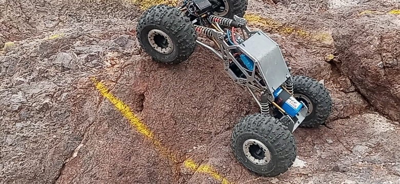

So it's been almost ten years since my last post on the creeper. It's still running strong after 7 years in storage. Have an axial clone trans with dig on the way. Sure wish they'd bring this truck back. I had a another still in the box ( when it was 100 bucks) but seems to have disappeared? Ran two packs Christmas day and what fun, hooked all over again!
