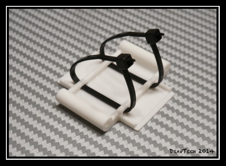

I also received the first part of the chassis, a 3D printed skid with some special features :)

The holes in the reinforcements bars are for zip ties.
Electronics securely fastened. I need to get some longer zip ties so I don have to put 2 of them together to reach around the electronic package.

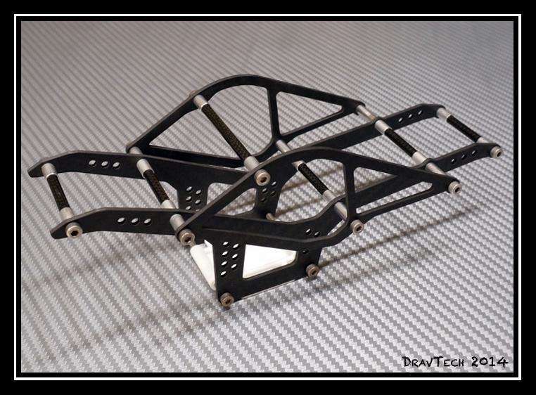

Yay, the CF parts has arrived! :mrgreen:
And I think I got enough "spares" to last a very long time...

I looted two other chassis to get some Magic Wands so I could assemble the chassis. Looks pretty good to me :)
I cannot complain about the weight of the chassis, especially considering the CF is 2 mm thick. If I replace the hardware with button head aluminum screws instead of the cap head ones and choose slightly shorter screws for the skid I should end up under 40 g :mrgreen:

Great work, just wondering why it does not have another cross brace in the cab? When you put a roof panel on it, it will sit funny and not follow the roof line.
On my SuDu, I don't have it either. You just have to make long enough roof panel, which is on top of the CF, then it's perfect. "thumbsup"
Well that is how the chassis was designed 8)
You fasten the roof panel to the front roof spacer and then to the rearmost spacers between the cad and lower plates.
