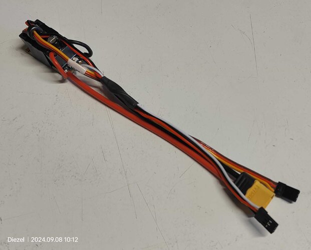

Personally I've found the DYS Aria AM32 35a to be a solid ESC, And even stacking Castle's largest BEC on it, provides no heat issues, and a decent overall package size. Especially if you run super short wires to the BEC, and then incorporate ESC signal wire into the second plug on the BEC output.
