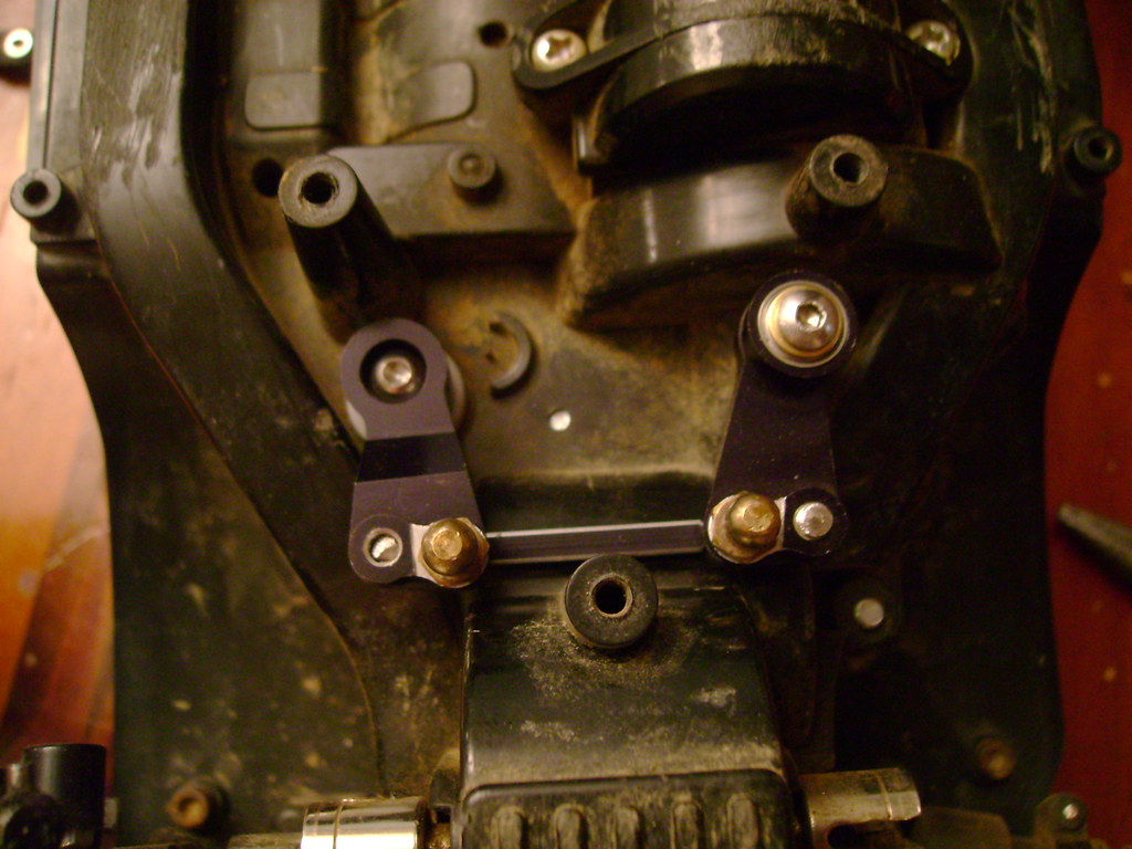

I'm positive that the slop is coming from the top and bottom arms where they attach to the shaft. 1, there is not enough material for the two(shaft and arm) to mate together and make a nice tight fit. 2, it never should have been a 3 piece design for that. Should have had the lower arm and shaft be one solid unit and the top arm be separate. Doing so would remove a problem area.
I attached the only issue I have with the steering kit.... limits my up travel but I can live with it. I have added a couple of spacers to take up some of the gap to help.
