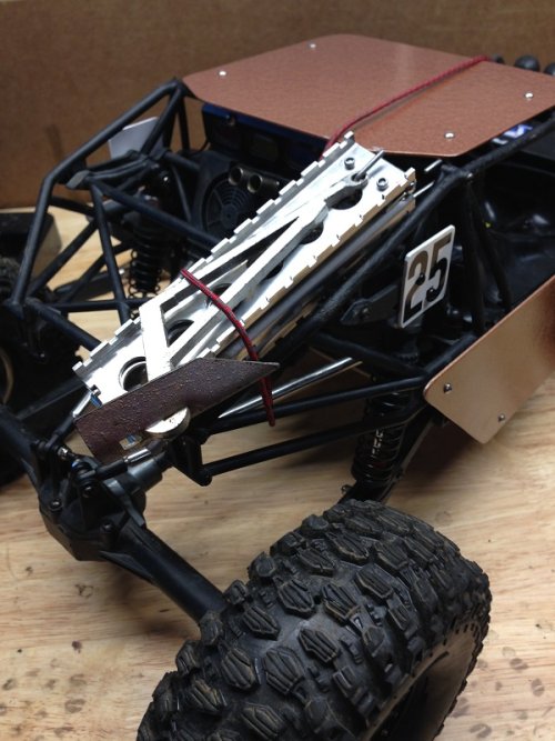

So it has been a few months since my last updated. Truck has been through a lot of changes since my last update. Truck has been reliable but I still worry about the poor parts support from Losi, which I feel is what is killing the popularity of this truck. Trying to stock up on parts when available, want to get 2 spares of the pinions/diffs. Really hoping someone makes a aluminum front diff soon, I'm really tired of it flexing and causing the ring and pinion to skip.
Updates since my last post.
1. Aluminum Panels
2. SSD Assassin Wheels
3. Hot Racing aluminum A-arms, knuckles, spindles
4. Boom Racing link set
5. Custom winch mounting for RC4WD Winch with Locked-up RC motor and line.
6. Number Panels
7. Sealed bearing for Team Brood Racing motor, re-coated the sensor board with con-formal waterproofing while I was in it.
8. Front light bar.
Let me know what you guys think. Tomorrow I am planning a quick shakedown run Saturday with a group trail run Sunday with this beast.

So now that you’ve had it awhile how do you feel about trailing with the rock Rey? Any changes to the locked front end? I’m trying to justify getting one and using it as my crawler/Basher/trail truck and live in South Georgia so most of my trails consist of tree roots, mud...and lots bugs. I have a smt10 I fixed up for trailing like a mega truck and a wraith cage along with a modded out twin hammers with xo shafts and b5 arms and a stock ascender. I love my hammers and on the tail it is by far the most capable but I fear breakage if I put too much power in it. So I guess my real question is would you pick up the rock Rey when you head out to wheel or a wraith with mods?
Honestly I like my Rock Rey better than my modded wraith. The only thing that hampers it sometimes is the clearance but honestly any time where I have run into that issue I have been able to blip the throttle to over come. Not to mention the COG due to the design is awesome for off camber and side hilling situations. If I had to pick between my wraith and rock rey, I would have to go with the rock rey. My suggestion would be to pick up the kit though so that you can put in your own electronics. You will definitely want a sensored brushless system. Also there are some "must have" upgrades IMO.
1. Either a aftermarket metal third member for the back axles or a aftermarket aluminum axle.
2. Locking the center diff with a Twin Hammers Locker. I did not lock the front, just put in some locking putty. I wanted some give if I was to get into a jam.
3. Front aluminum diff case
5. Aluminum bellcrank/steering setup. This helps to eliminate the plastic "give" that occurs when trying to steer against an obstacle.
Any other questions let me know!
