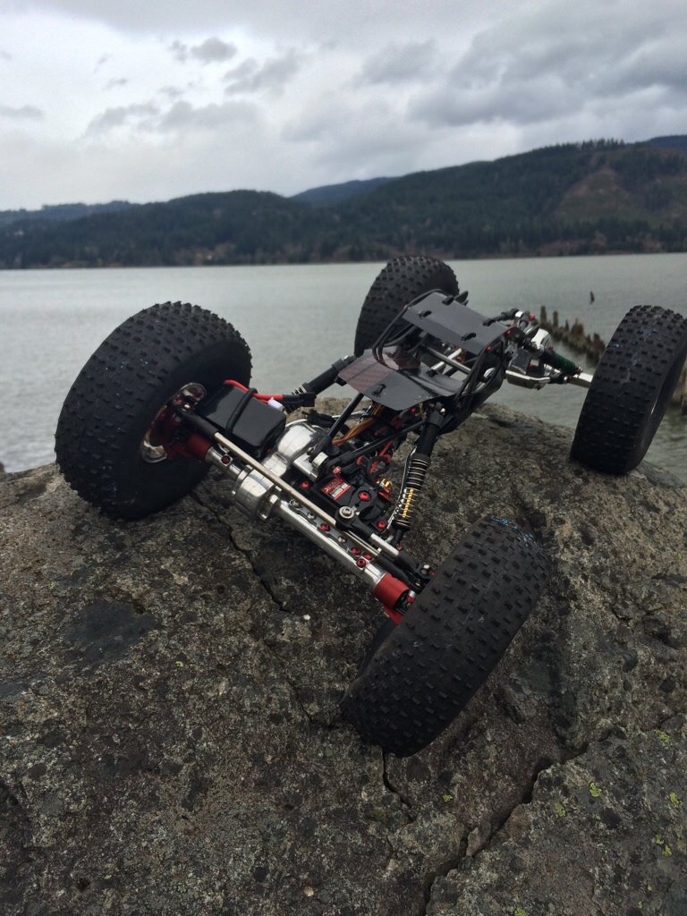

Here are some pictures of the crawler, all I need are some body panels
Minus the body panels this is my ready to run competition weight

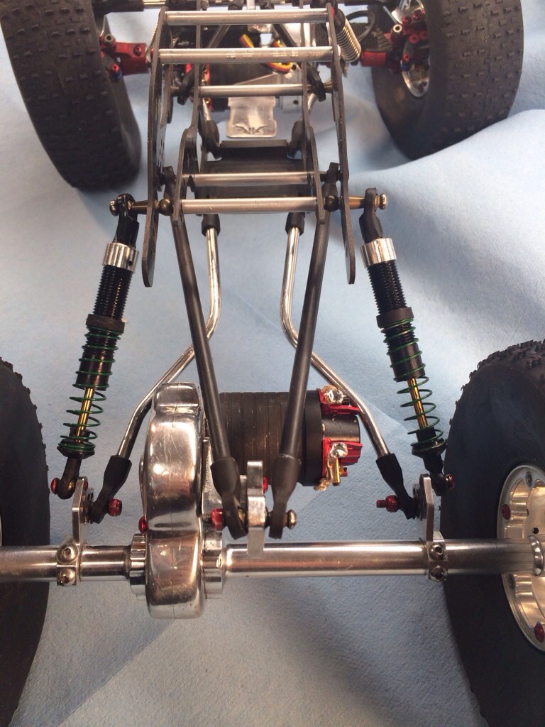

Does the frt wheel rub/bind agenst the battery during full lock? Rig looks good. "thumbsup"
Tight fit. :shock: I like how the placement gets the battery low on the axle. Nice. "thumbsup"
I have been so happy with this battery mount. We had some carbon fiber in the garage so we cut that and with one screw, screwed it on. The only drawback is you do need to use a short battery. The ones I found that work are the Max amps and the cheap battery packs which are hard-to-find these days. Here is a picture of the mount
