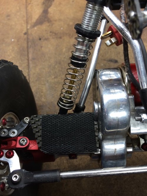

Wow it’s been along time since I’ve done an update. I went years with very little changes and it became time to replace some parts due to natural wear and tear.I needed new speed controllers and motors so I feel the only option was ordering some Homes Hobbie’s ESC’s and 400 13T puller motors.
In the meantime ordering some new parts I was able to get my hands on a set of aluminum fighter axles. Man these things are gorgeous. I decided to use the aluminum fighter rear axle. The overall width was narrower than my current set up which I didn’t like. This is where I had Tom make me some new tubes so I can have my overall width back. Tom can add the technical detail about the tubes, but they are sweet and holding up.
The only other change that I can think of is I gave up on the 7075 aluminum lower links and went back to titanium links. I was consistently bending the lower aluminum links which was getting old.
Here are a few pictures from earlier today.
Gotcha.
Did you machine the inner threads onto the tubing or did you find a .375” .5mm pitch die to use?
I am sure you can see how fun it was to stuff 7mm shafts in there... :ror:
very nice build. really like the time put into it and the red and alum polish n black. looks great. want to do that to mine. also cudos on dying threads on chromoly
may I ask, I'm a bit confused here, this is much bigger or at least a lot wider than standard berg axles. so is this still a 2.2 ? and do you find it to perform better being larger?
