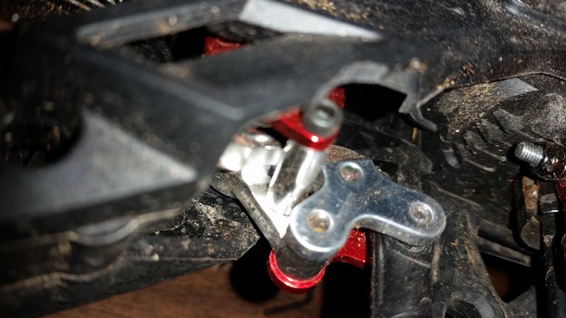

On my rig i found that if you try and mount the ax31160 68t spur gear inside the INTEGY C26124 Billet machined spur gear cover, you will have to clearance the housing for the gear.
Integy C26115 Billet machined gerbox case set fit beautifully, but i did have to drill out the casing for the hi/low shift shaft, The place to drill was machined almost all the way through so it was easy.
Integy C26116 billet machined steering bell crank and Integy C26113 billet machined steering rack both fit beautifully, but they do seem to limit the steering travel. I intend to machine mine to allow more travel.
The stock steering bell crank measured 9.13g
the Integy C26116 bell crank measured 15.31g
the stock steering rack measured 5.6g
the Integy steering rack measured 10.46g
KC Hilites Z-E0059 fits across the top of the body on the front of the top. Good bright light, I run mine at 7.32V and its great for those late night fun runs.
