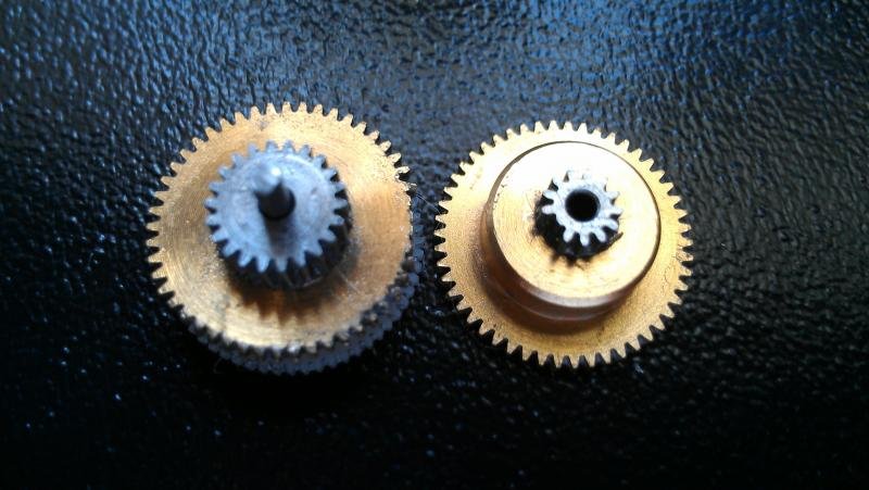

Having some weird noise in my airtronics digital 94851 steering servo. my tires turn fine both directions but when I turn twoards the left the servo keeps making a sound like its still trying to turn. And for a little while this morning it didnt want to turn one way but then went a way. Any ideas?. And do I have a pretty good steeri g servo?. My email is waitin4dv@yahoo.com im still trying to get set up on thos site with some pics.
what should I do new gears or new servo. And where can I het nee gears from. Its a airtronics digital 94851.
OUCH!:shock:
Since you could potentially have other damaged parts within the servo besides gears, I'd invest in a Hitech servo (if it were me). I've been running an HS-7954SH with no mercy and with no issues. It's affordable and super tough. It has about twice the torque of your 94851 and would be a good investment. Just my 2 cents...
Just chiming in to second that. About three years of hammering the crap out of a 7954-sh Hitec and not until the past few days did it show any signs of weakening. My new one will arrive tomorrow. In my opinion, it's the best value in crawler servos out there right now.
Yeah thanks for the help. Went and must ought the hitec 7950th. Whats the diffefence from the 7954 sh?
