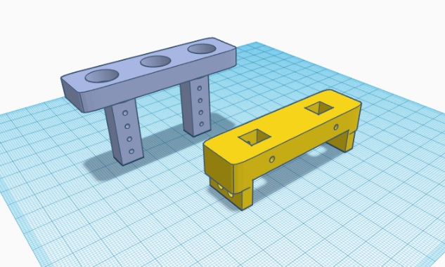

So I designed a magnetic front body mount for this project
I take a lot of measures but fortunately my first printing attempt was successful,
the fit between chassis rails is perfect but some sanding is required for squared post, anyway the sandind helps for better appareance
The STL file is available for free at Thingiverse
I recommend print it in PETG for durability 90% infill
It needs 3 neodymium magnets to be completed

you also will need 4 Knurled Brass Threaded Inserts (m3 size),
you can heat the brass insert using a lighter and then mount it in place
