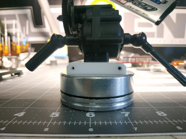

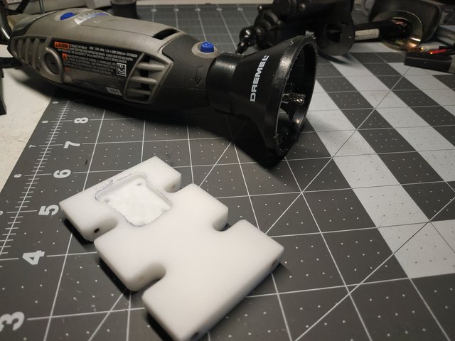

I notice that the Element RC stealth-x transmission sits too high, so I used my Dremel + router accessories to carve a hole on the Delrin skid plate lowering the transmission around 5-6 mm

Nice idea to carve out the skid plate!"thumbsup"

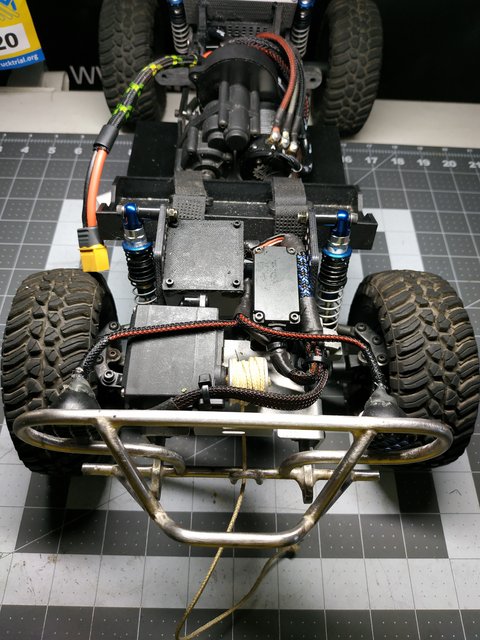

first thing to solve is the bumper design, so I took a lot of mesures an draw some basic designs that I can follow before cutting any steel parts
I am using harris 56% silver solder for this brazing work
notching the parts and set it in place before brazing was the most dficult part in my opinion
I also include a fairlead for the winch line, this is the final result
last steep was brazing a couple of tabs where I can mount the headlight cups, then conect that lights
Now I have to trim the body cab and solve how to mount the body, I dont want to Use clips
