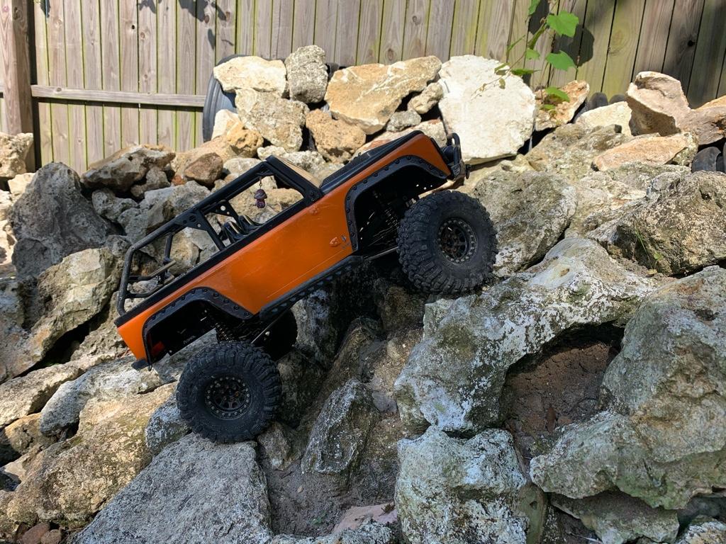

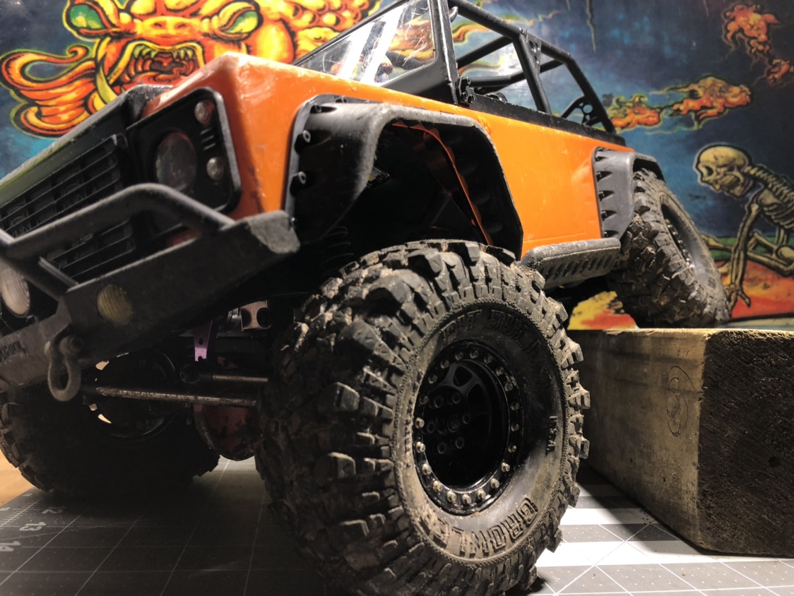

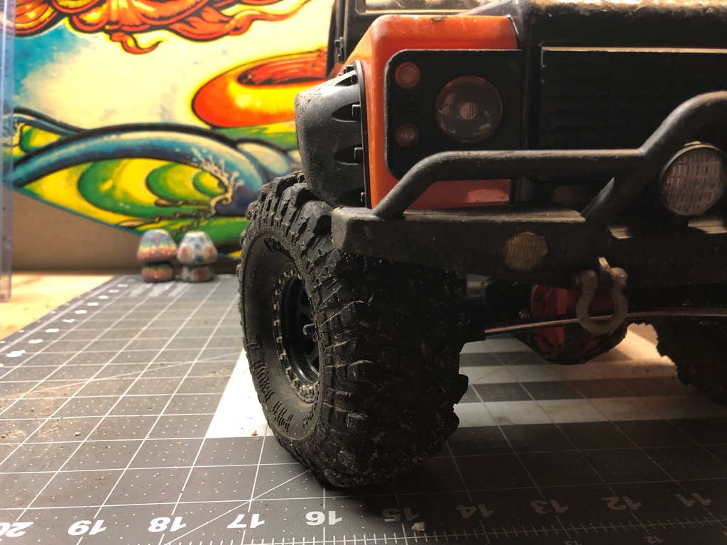

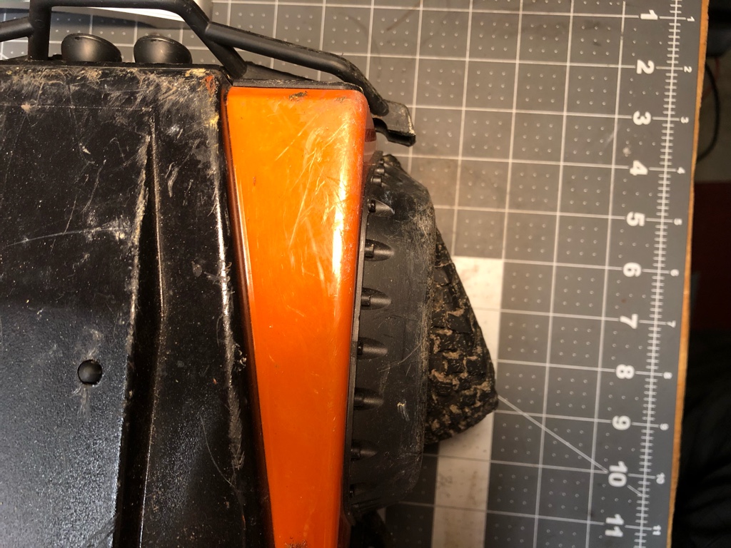

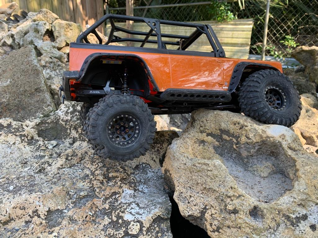

Small update for this awesome little crawler. Installed a Trx-4 rear bumper mount upsidedown in the rear with a bit of modification. It raised the bumper 1/2" giving me allot better clearance.
Did some trimming to the fender flares and used some heat to bend the rock sliders up a little. Now has allot better clearance in the wheel wells.
Then of course had to take it out back for a short test run.

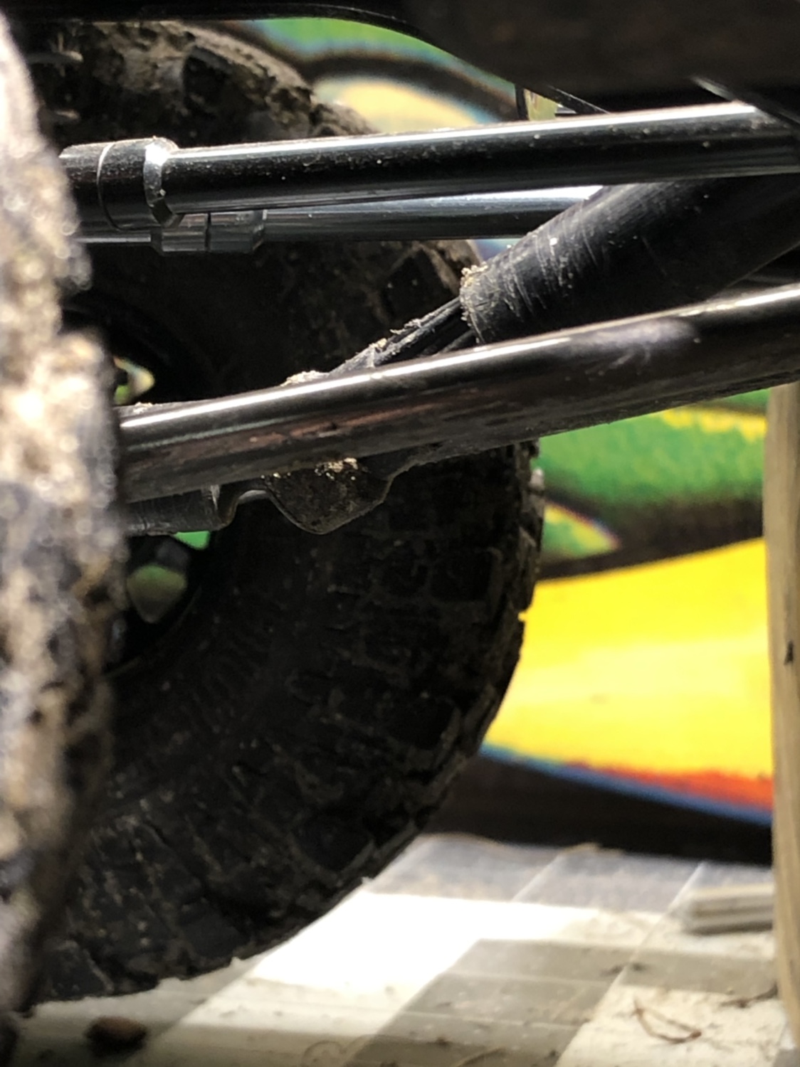

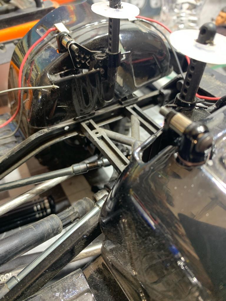

I just noticed this and I really don't like it. The driveshaft hanging under the links. Shorter links on the bottom. longer on the top will kick the axles the right way and keep WB correct. Once you've done that. How do you get the steering linkage and servo to work out correctly? Clockable C-hubs? Anyone wanna lend a brotha an idea? LoL! Any advice is greatly appreciated!
Looks like your driveshaft has been twisted a bit brother. Torquey lil truck huh? Lol
Sent from my SM-J327VPP using Tapatalk
I didn't notice that till you said something. You made me go pick it up and look at it. LoL! The rear has a slight twist. Good ol axial plastics LMAO! Guess that's something else I need to look into. It's definitely a torquey Lil guy.

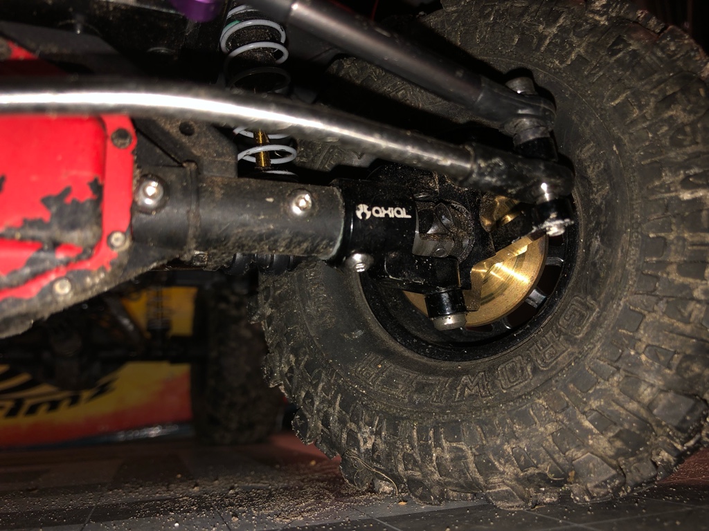

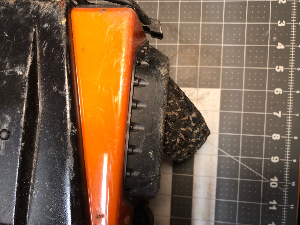

I've been trying to get more steering out of this rig since day one. I looked into 10-2 axles, XR mod and high clearance parts. With all of those being kinda high for my extremely tight RC budget. I found a decent deal on the stage 1 high clearance knuckles and c-hubs. I was talking to my good brother Codyboy about getting some more steering outta it. He said wait on buying the high clearance knuckles and he'd look around his shop and see if he could dig up something that might help. Oh boy did he find something!

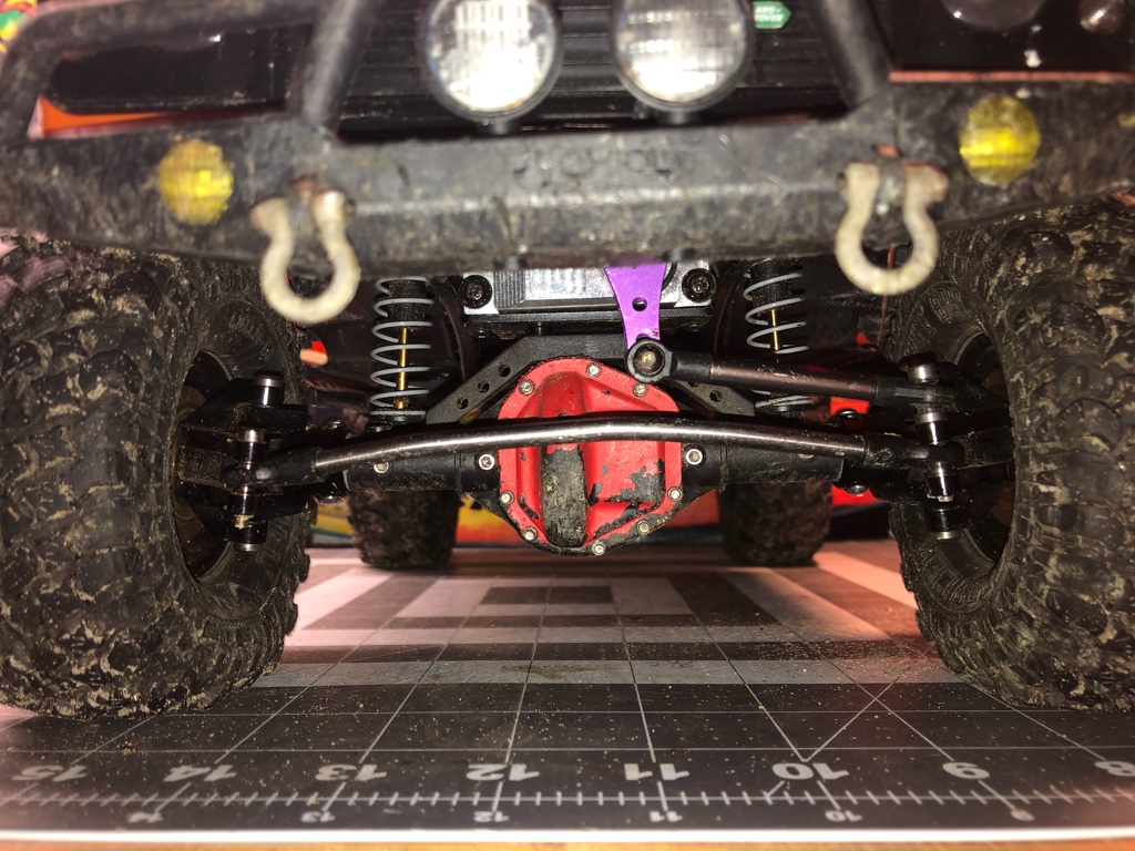

XR MOD!!!! He sent me a stock Scx10 axle with the XR mod installed! I went ahead and pulled everything out of it and installed it into my SSD D60 axle housings.
Man, did that make a difference!!! This thing really turns now! It went from a 9 foot turning circle to under a 5 foot turning circle.

XR mod added right around 10 grams to the front axle

Have crawled it out back a handful of times, but haven't gotten to really get out and do some good crawling with it. Joss is ready to get back out to the trails. Just gotta get some time. It does so much better that's for sure. I know I said it 1000 times already, but THANK YOU ERNIE!!!! You're one hell of a guy!!! Thanks for taking a look at my thread! Go Crawl Something!!!!

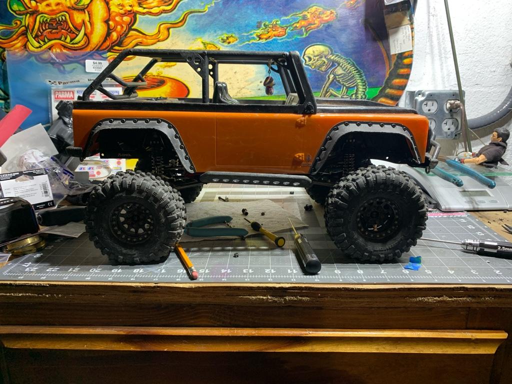

Once I got everything installed for the front end. I did a test just to see how much slower the Trx axle was compared to the SCX10 axle. Both with stock gearing. The SCX10 axle was 2.75 turns to 1 turn on the Trx-4 axle. The Trx axles definitely make the chassis sit higher. About 5/8" higher.

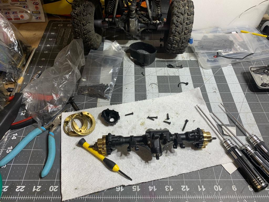

Installed some MFR outer portal covers on the rear axle. Then installed it. Other then changing a few rod ends to get the axles to sit correctly. It was a very simple install.
Now trying to decide on how I want to get the chassis lower. Either going to 80mm shocks or using shock mount extensions and having the 90mm shocks go through the inner fenders. Haven't made up my mind yet.
As for my goal of 8mph with the Trx axles and a 21t trailmaster sport...... I think it tops out around 5ish mph. Think I might try to find a 12t trailmaster sport. Sometimes you need a little more wheel speed due to allot of loose terrain here in FL.
Over all it crawls really good and is allot more stable then before. Despite the chassis being a bit higher.

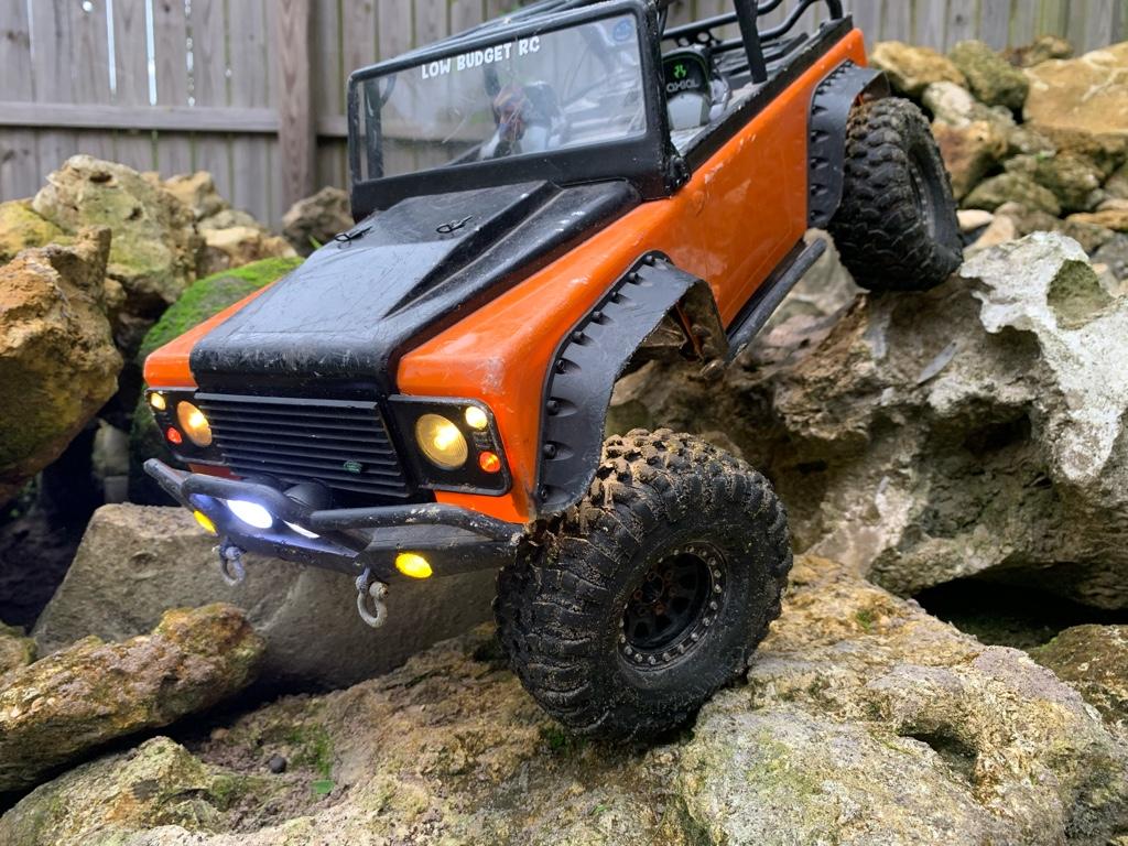

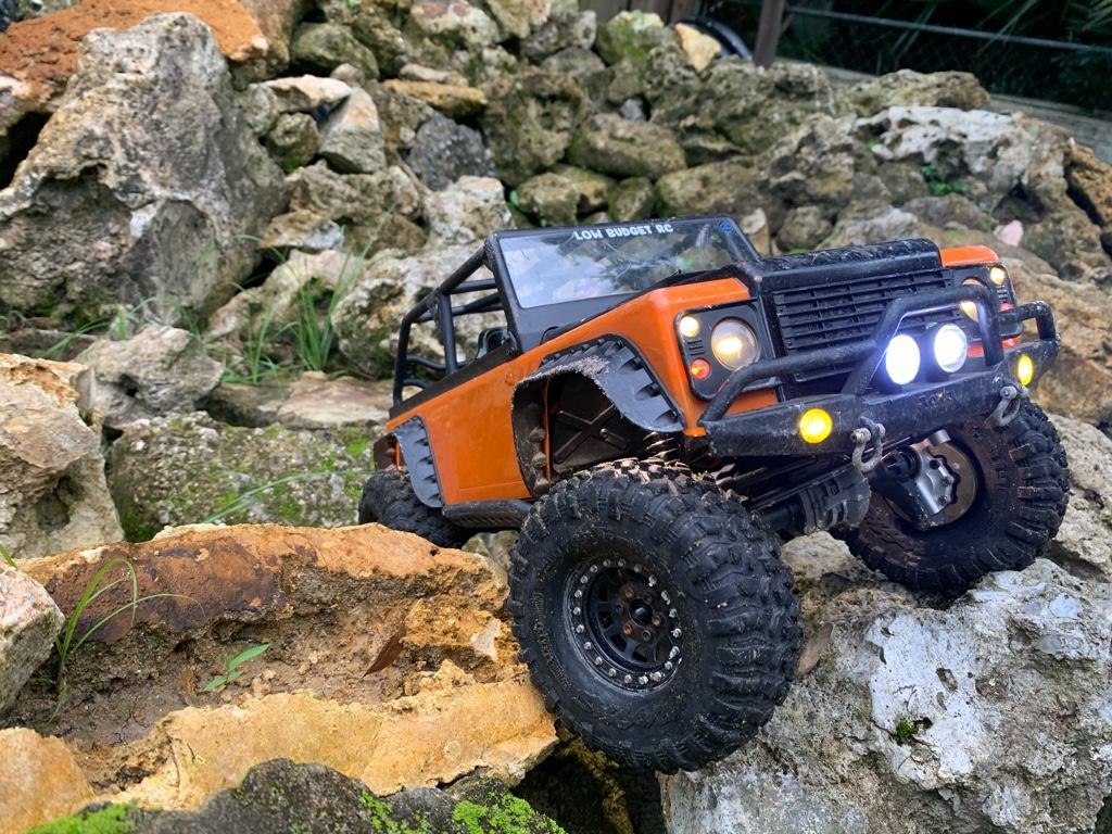

I ended up going with some hot racing capra lift kit brackets. To get the chassis lowered.
The holes weren't exact but a small amount of Dremel work wasn't bad. They ended up giving me the exact amount of drop I was looking for. Now the shocks are through the fenders.

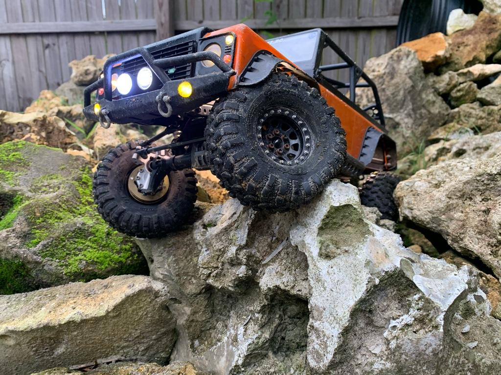

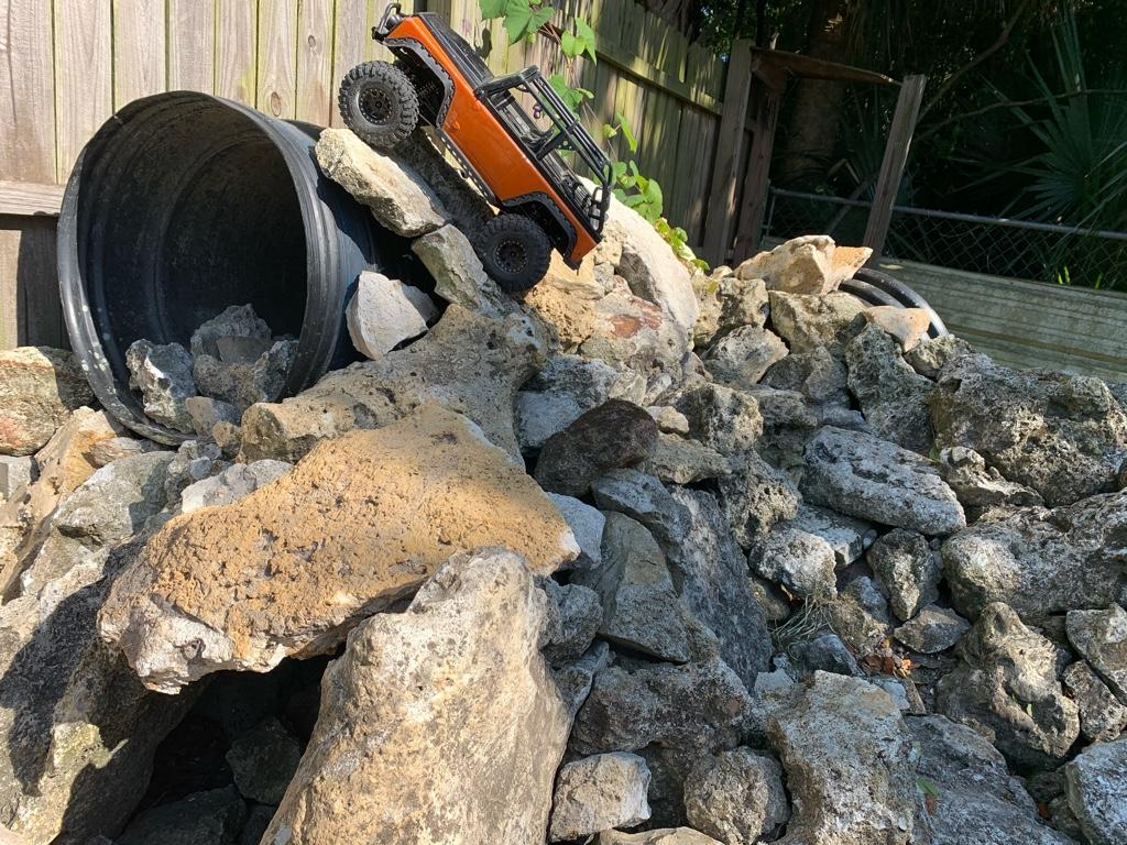

Took it out for another year run yesterday.
One word..... Stable!

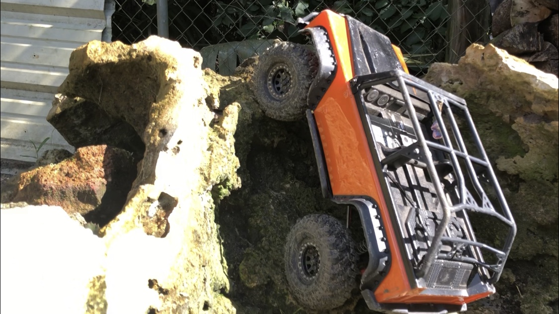

This thing crawled all over the place. With the short WB it doesn't like vertical climbs much, but anything else... It takes it! I crawled some lines I never thought it would hold. Surely never would have before. By the end of my rock therapy session I had broken some rod ends and sprung a leak in a tires.
All in all it was a great test run. Now time to build some new links using better rod ends and find this dang leak. Thanks for checking it out!!! Have a great day!!!!
