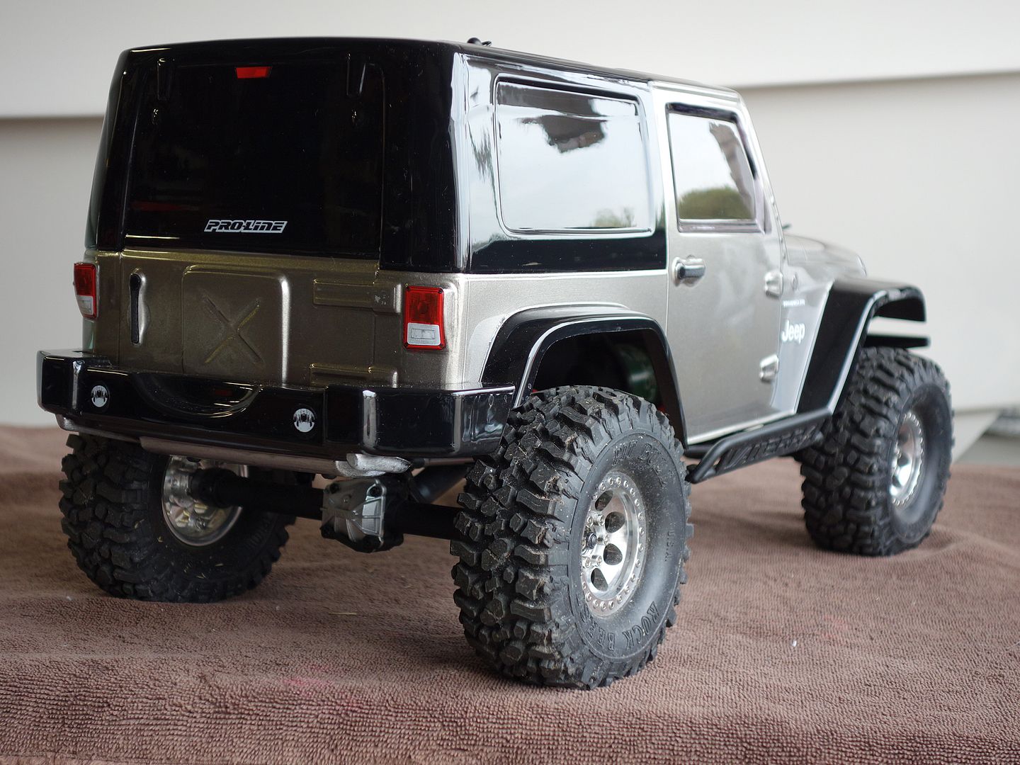

A few more pics here from the better camera...a Sony RX100...

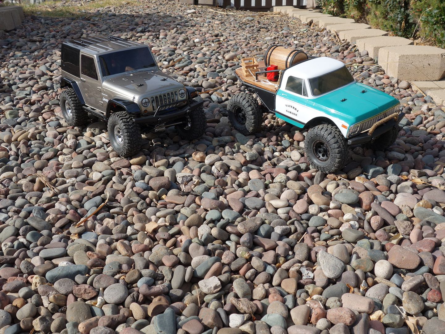

I'm happy with proportions and how the body matches up to the Ascender chassis:

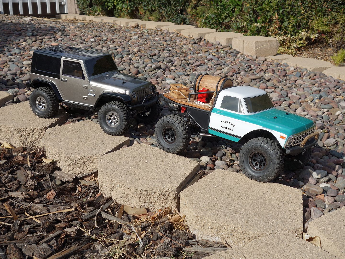

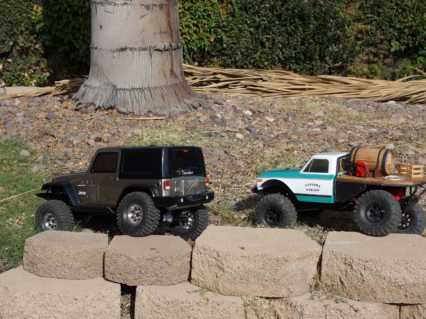

K10 RTR on top, the Wrangler on WB3 below - there's just a half inch difference in wheelbase but virtually the same length overall. Everything fits better on the one I built. 8)
Happy with how all this works too. I would like to try a set of 4.19 tires and run it in Class1 - we have a local SORRCA meet this coming weekend. I may be able to run Jeep in Class1 and the K10 in Class2:
Two Vaterra Ascenders, very different flavors, both run about the same though. The slightly taller tires and shorter WB on the K10 more than makes up for the better traction of the Pitbulls on the Wrangler, but it hangs up easier cuz less ground clearance. Both very fun to drive now.
Whatta pair!
