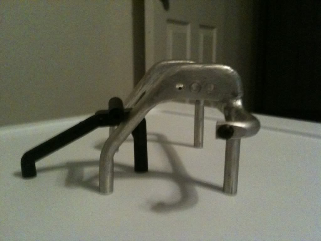

OK so I picked up the new Shock Towers from Jerry at DMG and let me start by saying the quality of these things are sick. My brother is a certified welder and freaked out on the awesome welds and craftsmanship put into these.
Here's a side by side with one of the stock shock mounts.
