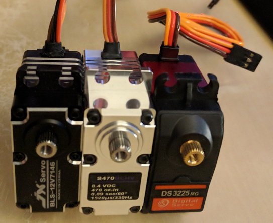

Received the DS3225MG today - it's got a taller case than standard servos, even a touch taller than the ProModeler 470oz-in.
Should be perfect for use as a 1/8th buggy servo, as I noticed my Team Associated Nomad DB8 (based on the chassis of the RC8 and SC8 racers) uses 2 spacers to elevate the RTR servo.
Removing one or two of them should allow it to fit as intended.
The increased size is likely because of larger components, explaining the higher torque available at a still-affordable price.
Might hit upper links if mounted on-axle with flipped servo mounts...(?)
BTW - I've spotted this servo over at Banggood.com for $14.99, so as long as you can fit it in your vehicle - could be quite a deal.
Pics are showing size comparison next to a JX 12V BLS (which I still have never powered up) and the aforementioned ProModeler, couldn't show my Holmes Hobbies SHV-500 v1 as it is still kicking ass in my Revolver-powered Bomber... ;-)

Looks pretty good! Maybe the new best cheap servo? I did find a blue cased one but the red one claims to be waterproof as well. I may have to get a few of these for my Summit. Any idea on amp draw yet?

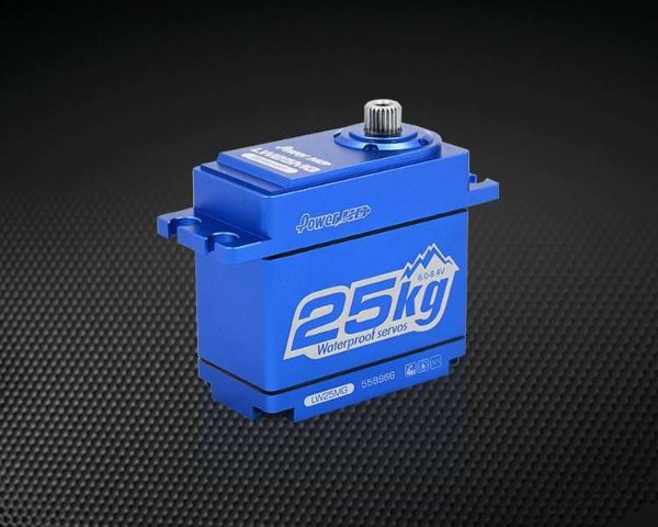

Power HD have introduced a budget-friendly HV waterproof servo LW-25MG.
It makes use of a CNC-machined all-alloy case for improved durability, newly wiring outlet structure for enhanced waterproof function, having 36CM wire to compatible with Traxxas TRX-4 wiring.
It is usable with 6.0V to 8.4V input, offer a torque of up to 25kg-cm at a speed of down to 0.14s.
LW-25MG Specifications:
Torque(6.0V): 23.0 kg-cm (319.4 oz/in)
Torque(7.4V): 25.0 kg-cm (347.2 oz/in)
Speed: 0.16 sec (6.0V) │ 0.14 sec (7.4V)
Operating Voltage:6.0 ~ 8.4 DC Volts
Weight: 72 g (2.54 oz)
Bearing Type:Ball Bearing x 2
Motor Type:DC Motor
Gear Type:Copper & Aluminum
Operating Temperature: -20℃~60℃
Working frequence:1520μs / 333hz
Size:40.7 x 20.5 x 38.6 mm ( 1.60 x 0.81 x 1.52 in)
That looks promising, but at $45, it's going to have to prove itself to be very durable considering other contenders in it's price range (mostly thinking of the ~$35 towerpro mg959, though it is not "waterproof")
And what is it's draw on full stop? Pretty much anything over 20kg is gonna need an external bec. Which is fine, but you need to consider than in your setup, choice, skill set, wiring, etc.
