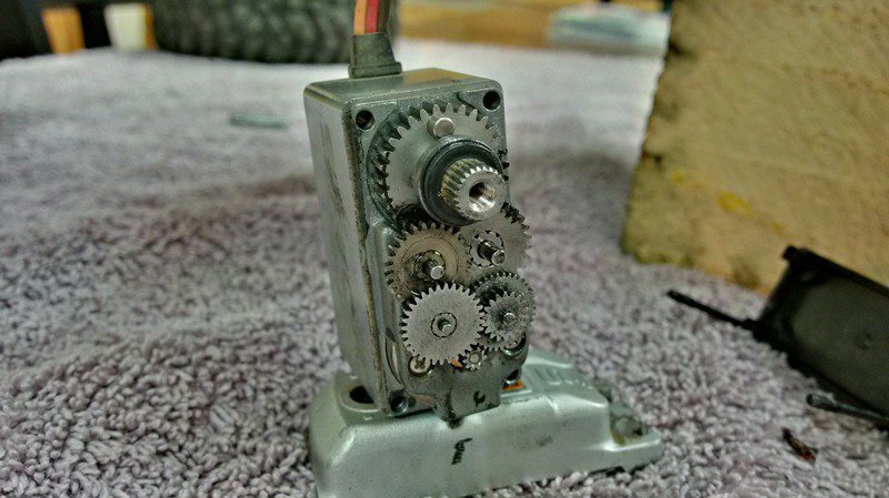

Not sure why nobody including savox doesbt copy the savox 1283sg gear design. You will break the case before ever stripping a gear
Now if they just waterproofed it and made the case stronger.

Load bearing gear is still on bottom which is the typical design of all servos and why they all shred the same gear. Look at the first photo. You'll notice the applying motor gear is not on the bottom. It's going to a lower geared gear allowing it to take a beating without stripping teeth.
You will break this case before anything else
Broke the limiting tab inside the case....
Now I will say savox warranty sucks. They're currently trying to tell me just replacing the front case will save the servo however the potentiometer spun passed its program points and now only centers hard left. They currently dont feel that's manufactures defect.
That is a robust looking gear-train but more gears introduces more slop, manufacturing cost, wear points, weight, just make better gears, cases, pins and pockets for the pins, be done with it. "thumbsup"

Sorry to say, I've seen and heard more first-hand Savox servo failures, problems and non-existent warranty than any other brand, coupled with the noise they're known for, I'll pass thank you. Good luck with them, clearly your whole servo should be gone through and rebuilt after that kind of damage. "thumbsup"
