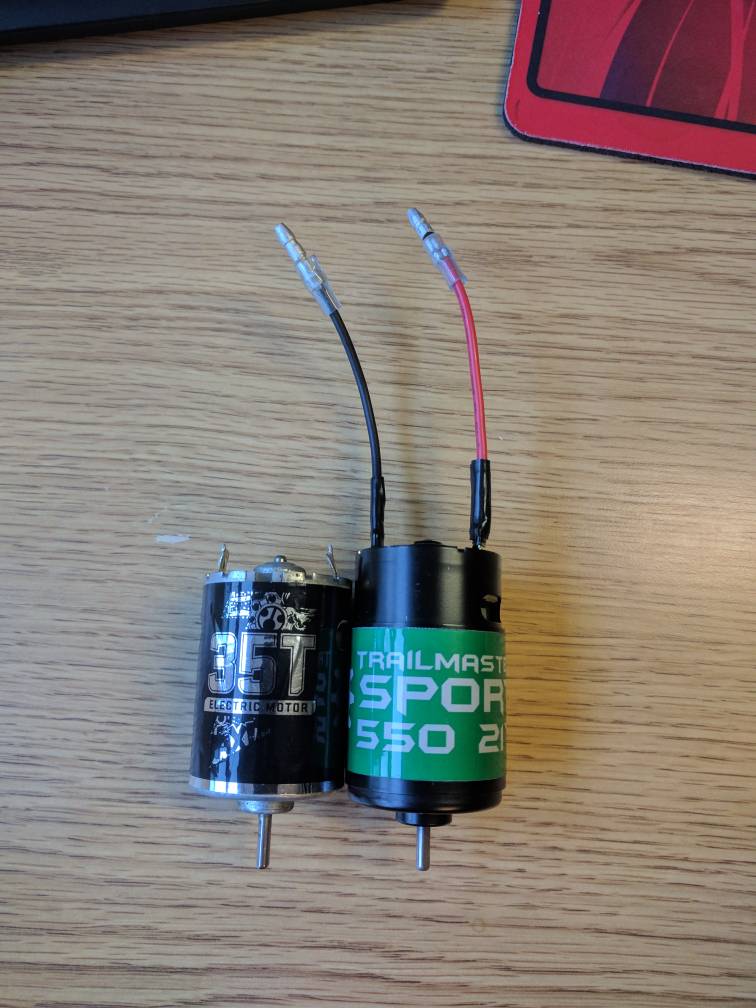

I have seen that the 550 can will not fit the rtr transmission. It will however fit the kit trans
Thats the issue
It hits the battery tray.
I have one and was going to put it in my kit 10.2, but nope wont fit.

Don't get the 550! Does not fit. I guess I'll be ordering the 540 motor. About a quarter inch too long and hits the battery tray.

Yeah, I'm really not trying to notch into that corner of the battery tray though. That's the corner I have my battery pushed into.

Can't you flip the trans around like the old scx? Would put the motor out the back
Is there really a pressing need for a 550 in the scx2? Apart from potential physical size issues, would it be unnecessarily heavy? How would the 540 27t trailmaster compare?
