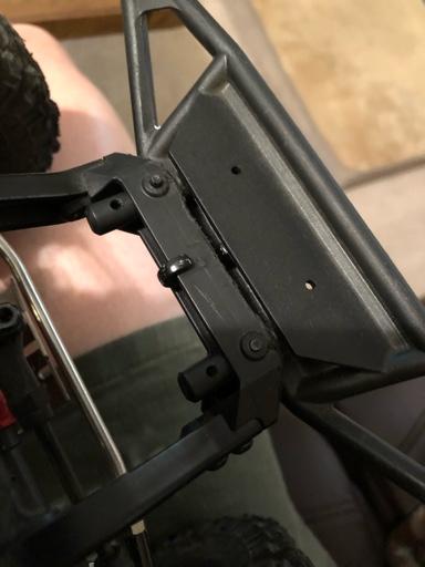

As far as the Sport model the winch will fit the original bumper and installs basically the same...the fairlead will only be the faux fairlead molded into the original bumper so I just took the enclosed fairlead on the new bumper and installed it on the original bumper...that gave me the option to keep my light bar above the winch instead of below the winch.
Really wasn't fond of having the light bar be the lowest portion of the bumper with the recommended bumper.
Below you can see I went back to the original bumper with fairlead from new bumper installed on it. ( truck on left)
Also on that truck the bumper mount on frame is flipped over for extra clearance
