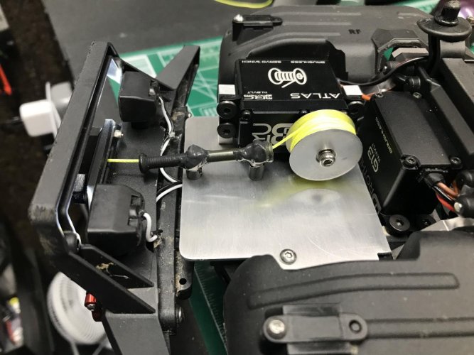

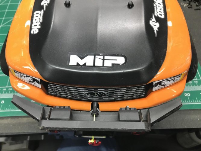

I added a 3Brothers Atlas servo winch to the front of my TRX-4. I made an aluminum plate to fit where the original plastic battery tray was on the front fenders. I used 3/16" brake tubing flared on both ends to run the winch cable thru to keep the winch line centered in the fairlead. I used rod ends with JB Weld to mount the brake tubing to the plate. Also added an SSD Scale Hawse Fairlead to the stock TRX-4 Sport bumber.
If you'd have just flipped the winch over or reversed the channel to pull from the bottom of the spool that whole brake line guide contraption wouldn't be necessary.

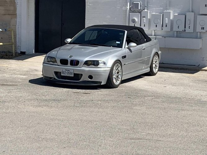

Off topic... that an E46 you're sitting in?![]()

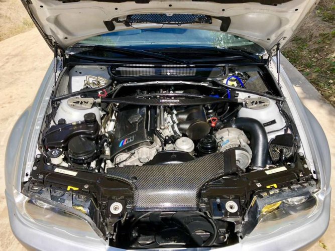

That's a sweet car. I really want an M3, but for now I'm making due with a 330Ci. Almost pulled the trigger on an M3 this last tax season, but had too many other things I wanted to take care of first... maybe next year, lolLol. Ya. Csl m3 built by ecs tuning for euro tuner mag. View attachment 380481View attachment 380482
