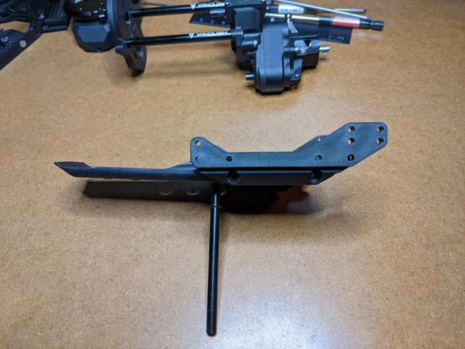

will a VFD trans/skid bolt in to a SCX10ii chassis with little to no mods?
The VFD skid won't bolt up to the stock Axial SCX10 ii rails and the VFD transmission would also require you to change the front axle to one with an offset pumpkin. You may be able to grind down enough of the skid to get it to fit in the rails but there's no way of getting around the axle issue other than to swap it.
Also, for those that have asked, the distance between the VFD motor plate and the transmission is 59.75mm measured with calipers so that would be the longest motor that would fit. If you're using a brushless motor that has the sensor wire coming out of the end of the motor you'd need to consider that in the overall length since clearance could be an issue.
The VFD skid won't bolt up to the stock Axial SCX10 ii rails and the VFD transmission would also require you the change the front axle to one with an offset pumpkin. You may be able to grind down enough of the skid to get it to fit in the rails but there's no way of getting around the axle issue.
Thanks. If it were possible to put the VDF in the SCX10 ii I would have either gone SCX10 iii straight axles or use a SSD offset pumpkin housing for the AR44s
