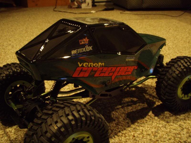

Venom Creeper Crawler
My first car since Tamiya Holiday buggy
Venom Creeper
Novak Rooster Crawler + Fifty Five (combo)

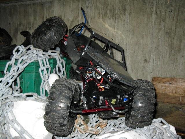

2.4Ghz Radio (tested with Esky 4channel to my helicopter but I intend to use my DX7 and AR6100 (6 channel rx) and trick it with remote lock diffs and steering front and back
I soldered an Y-cable that allows me to connect 2 LIPO'S at the time
2S 900Mah is what I have around...so 1800Mah will do for now - but I have already planned in adding a 3rd connector
I flipped lower "Z-bend" links to allow more clearance
Updatedpic
http://www.youtube.com/user/MrKalaspuff
Some tweaks after videos
Moved rear supports in front of axle and removed skid (but put the supports back after deanodizing)
Added weight to wheels
I used 1.5 mm solder and cut it to 1meter lengths, 4 in each tire front and 2 in rear tires (1.5mm solder weights 9gram/meter)
199-207grams stock wheels
259/251grams after in front wheels
229/230 grams after in rear wheels
I will buy 1meter aluminium rods and make some links myself...to allow BTA (behind the axle steering)
