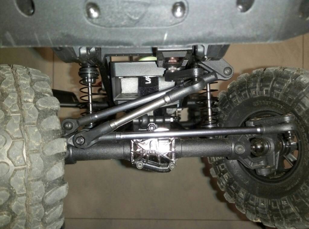

Here's a front view. I don't see any obstruction with the setup. What I noticed when manually turning the servo without power, it can do a full left same as the right. Would a simple realignment of the servo arm to be centered fix this? Oh and do I have to tighten the links a bit or are they really supposed to be loose?
Do you have the servo endpoints setup correctly? They should be set so when at full lock, the arms almost touch the stops. And is that servo horn seated all the way? Seems like a lot of spline in showing.
I haven't touched anything out of the box really. Will try the adjustments tomorrow. Regarding the servo endpoints, how do I do this correctly? On the tx, steering is set at the maximum allowable already.
You have a RTR right? If so, I'm not sure if it has epa. If it doesn't, then you can possibly play with servo horn positioning to get some more throw, or change the servo horn for one that has multiple holes to attach the steering link to.

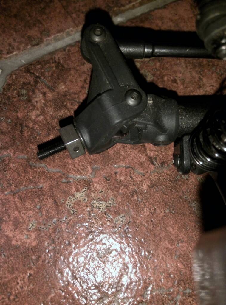

Here's the right side steering, the knuckle is right in line with the stopper. I'm not sure if I'm getting the terms correctly but the stopper is that plastic sticking out on the top part of the C-hub right?
This is the left side. There's a noticeable space between the end of the knuckle and stopper where the steering can still go further. I have yet to disassemble the servo horn and links. So safe to say it's not the stoppers holding it back?
You should get more left steering...it should be able to touch that stop.
Since the wheels travel to full lock without power, that would seem to rule out a physical obstruction. Adjusting the servo horn would be worth a try. If your trim is set to the left, center it and reinstall the horn so that the wheels are pointed straight (or as close to straight as you can). If your trim is already centered, try rotating the horn by a tooth or two in the clockwise direction and retrimming to see if that helps. If that still doesn't work, it's probably an issue with the servo and worth contacting Horizon.

Yes, when my LHS guy opened the box, we had to adjust the st. trim almost 90 degrees to the left. I figured just twisting the servo horn to center without power will align it. Now it seems that with the trim adjustment, we ate into some of the steering angle needed to make a full left.
Will update you guys once I do some more tinkering, will also retighten the steering links, might be able to solve some of the front tire wobble as well.
There's your problem. Small trim adjustments are fine, but if it needed that much trim, much better to rotate the horn. Let us know if that fixes it.

My first Ascender RTR steering was fine, my second RTR requires lots of trim to the left also. I'm going to have to pull the servo horn, rotate it one spline to the left and readjust trim to center steering. You need to do the same thing. Not sure why Horizon/Vaterra doesn't check this or have an adjustment jig for when they assemble the RTR. :)

So update guys, disassembled the servo horn and realigned it, only needs around 45 degrees trim adjustment now to center. Steering angle is still biased to the right when tires are on the ground but when lifted, both sides hit the stoppers.
When steered to the left while reversing though, I can get the full steering angle. I couldn't quite get the perfect alignment since I might strip the horn when adjusting. I'm thinking of getting an aluminum horn to replace the stock plastic one. Any thoughts?
