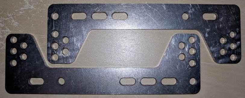

https://www.scalerfab.com/products/scx10-rock-slider-chassis-cage-brackets-w-link-riser-mount-2
They make another version that are even cheaper ($9.95) for those users retaining the stock Vaterra battery tray:
https://www.scalerfab.com/products/vaterra-ascender-slider-chassis-cage-brackets
I'm going to be painting mine black to blend in to the chassis a little better, but they allow for multiple choices in mounting the suspension links...
Did you receive your scalerfab link mounts yet? Got mine in today and having issues trying to figure how to put it on. I searched YouTube and couldn’t find any information on them.
Nvm, I was able to get it figured out. I ended up tearing some things to try and figure out how. Silly me. Now, onto gettting rock sliders!

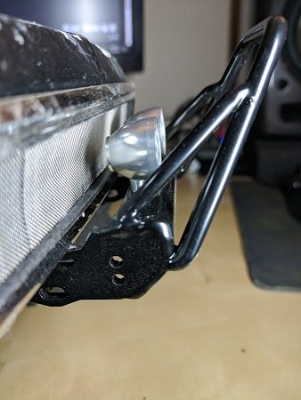

See anything wrong? (first pic)
(hint - look closely...) The Boom Racing front shock towers are not mirror images of one another - the damn body post holes are out of line! I had installed them, was about to thread the plastic post down in and noticed the hole was drilled off-center for the grub screw that keeps them in place, THEN I noticed the whole damn thing was cast incorrectly - almost as is the part was for another vehicle entirely - but even then the mis-drilled grubscrew location is a complete FAIL.
Needless to say, I'm going to notify AsiaTees/Boom Racing of this, maybe they can just send a gunmetal replacement set if they check out... not sure if ALL the black ones are defective yet...
For now, DON'T ORDER part # BR682004BK for the Vaterra Ascender... (!)

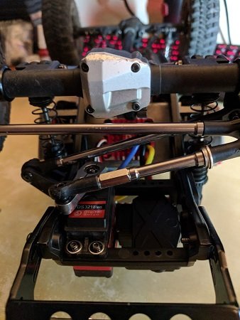

2nd pic, had to bend RULR to clear 550 Holmes can - may make a cut here and refinish or perhaps even cut a similar version myself later on...

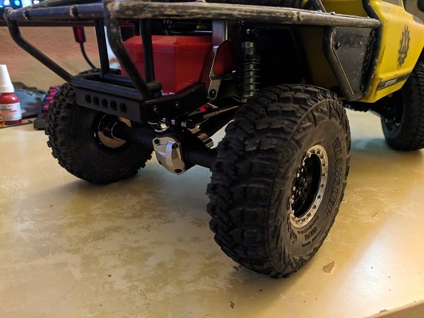

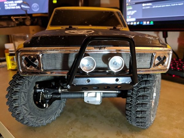

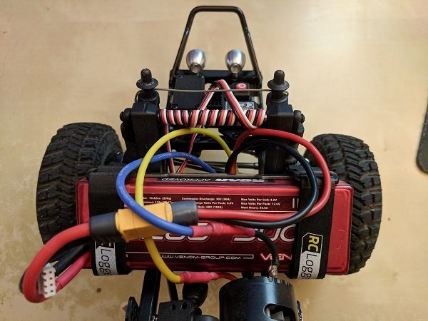

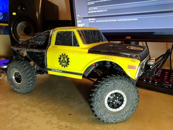

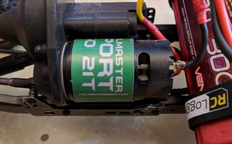

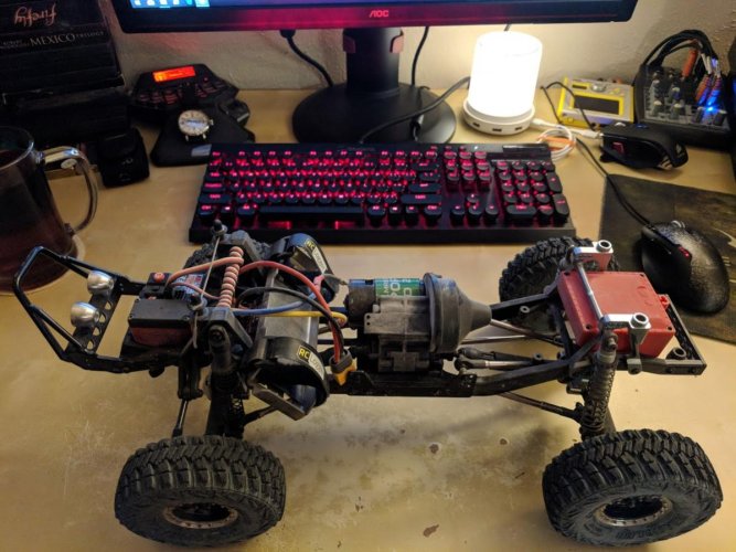

Other pics - I installed the WertyMade bumper, Gmade headlights (without wiring them up for now, no bulbs in housings), TRX-4 rear shocks (not the fronts because without installing the Boom Racing front towers I had no way to mount them lower), SSD Brass rear axle ends, RC4WD 1.7" Raceline beadlocks w/RC4WD Goodyear MT/R 1.7"x4.19" tires w/stock foams, 18t Robinson Racing pinion (to make up for tire size reduction).
I redid the servo & electronics mounting AGAIN, found a very entertaining olution to extending my drag link... (used a bit of hardware from a CPU cooling fan mount... and I have a couple extra! They are hex-shaped, with M3 threads on both ends).
My run was cut short by a sudden hailstorm (!!!)... but all was fine, speed and handling was fine, less rollovers with the SSD weight, LOVIN' the tires!

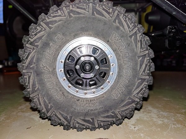

1.7 wheels huh? Makes the tires look much larger than 4.19.
They would look good on my TJ copy - the original had MTR's - best tire back then - a lot of the BFG's would get sidewall slices but not the GY's. "thumbsup"

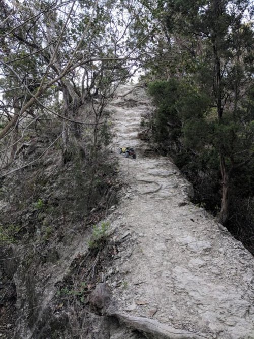

I downloaded an inclinometer app for my Pixel XL to go back to the drainage area, I climbed up the most insane angle, was that grippy concrete... Not a "real" crawling test, but I was just in the office park behind my apartment...
