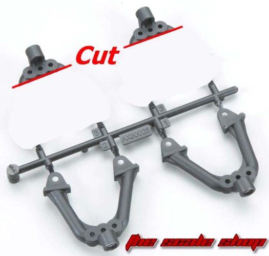

Not that this would be a problem for a lot of us here, but what about body mounting options? I know that the stock shock tower/hoops are flexy, but the built-in adjustable height body post mounts are really convenient.
With the electronics box revision, this would then be a truly bolt-on affair.
I do have a project in which I can use some custom rails, so I will PM you the details once I have my parts orders finalized.
the stock body mounts bolt right up. i will do a full build thread showing how.
basically you just take the stock plastic shock towers, and cut off the arms. leaving just the upper holes and body mounts. then when you bolt up your shocks go threw the steel and plastic too behind it. and walla. magic. factory body mounts ;-)

I was just wondering about this exact same thing. Will the stock chassis holes match up the same with the mod and new chassis? Reason I'm wondering is I have already drilled the holes in the stock configuration on a new body.

They are off by the width of the chassis rail. You can easily grind this width off of the plastic shock tower/body mount.

as soon as I get some time ill assemble one of each and get you a measurement."thumbsup"
thanks!
that's a great idea corky, by narrowing the plastic you could adjust the location. and also by flipping sides of the chassis rails. great thinking.
