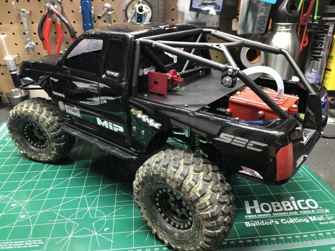

I did mount the Honcho & Cage to my TRX-4. Had to modify the bottom of cage to fit over the battery. I currently do not have a pic of the modification, but I can get you a pic later today.

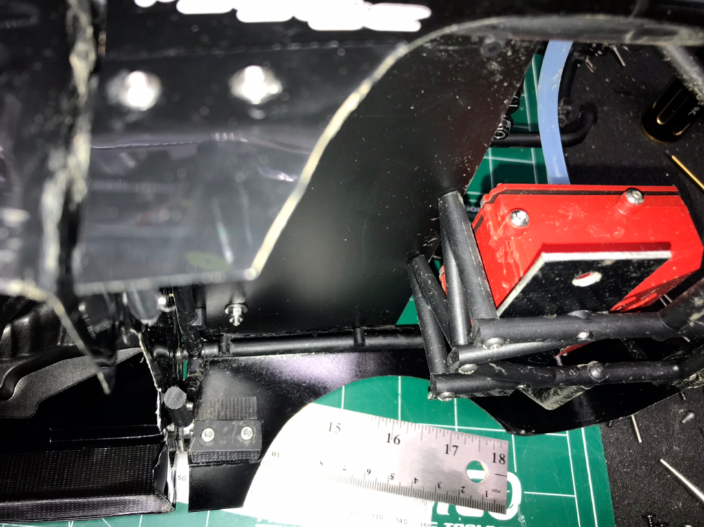

Here are the pics of the underneath. I am also using the Bowhouse battery tray which sits lower in the chassis. The rear body mount is different than the stock Honcho cage, so it’s up to you how you want to mount it. I used the outside scrap lexan piece of the cage lexan instead of the inner lexan that is supposed to be used. In the last pic, you can see the rear body mount. I just screwed them into the rear chassis brace. I hope all this makes sense!
