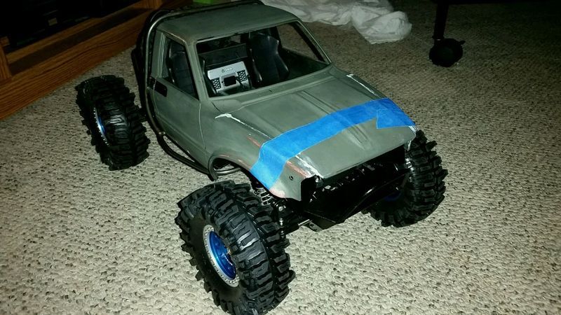

TRUGYOTA!! Yes another F@*! Hilux Truggy :-D
Got my combo kit from GCM Racing and fitted into the truggy.
:badger:

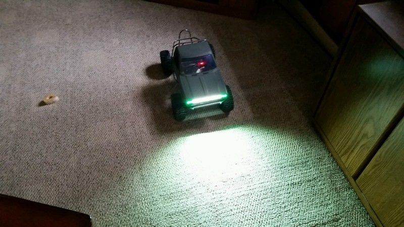

Well a small update. I got it to move under its own power with some misc. electronics I had laying around. As you can see. the gear head light bar works as well. Now to figure out where to mount all the electronics and to finish up the interior.

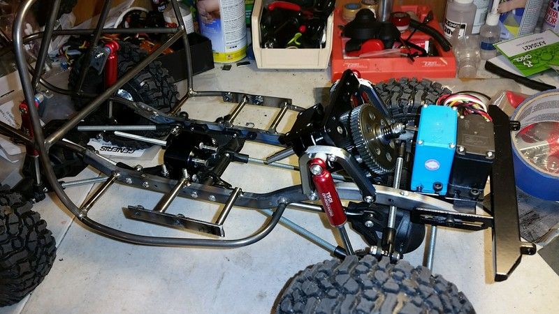

Rear four link risers welded in place. Strong like bull! :-D

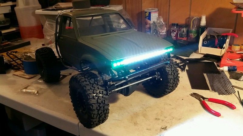

Decided to go with a yota grill over the full LED light bar.

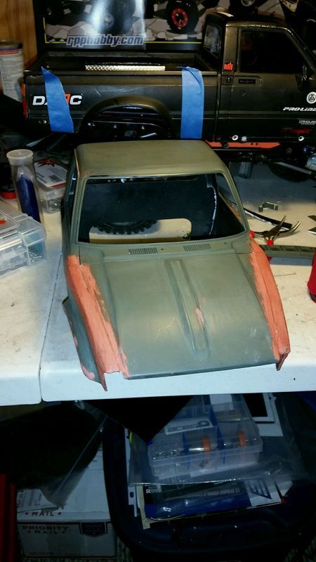

made a spare tire mought that can be removed from the truggy with no problem. "thumbsup"

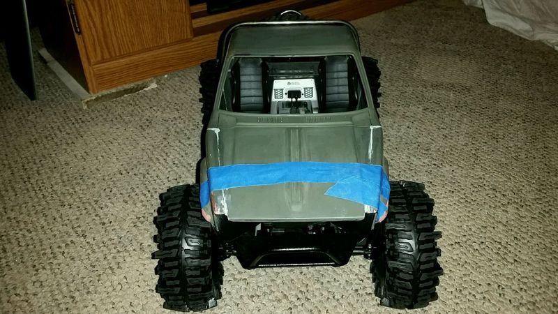

There we go! Love the pinched yotas. I'm really digging your cage. I wish I had built my own. Lesson learned.
Have you decided on electronics yet?

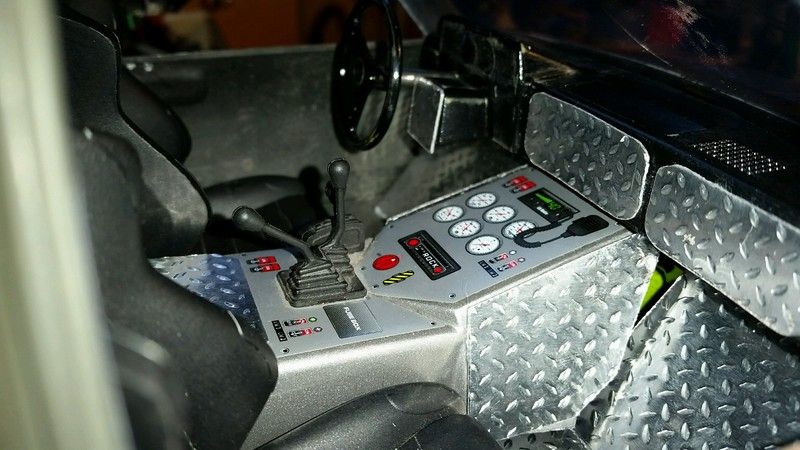

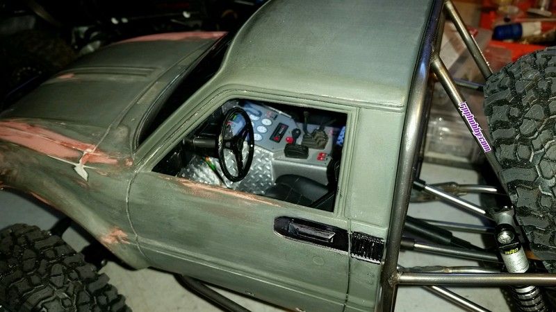

Still trugging along on this project. :-D
Interior is getting there.

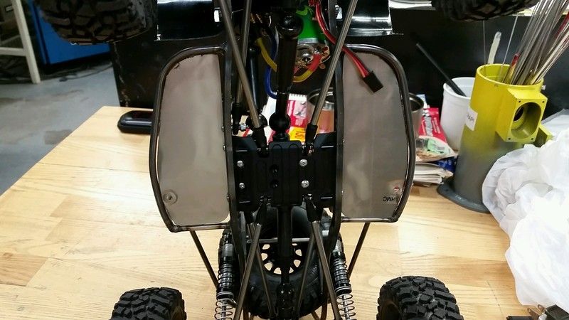

Made some Stainless steel slider / electronics plates today.

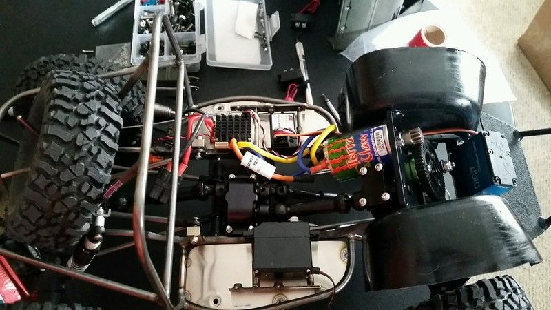

Debating on where to mount the servo winch. No the Novak terra claw isn't staying in it. Was just there while I was building the truck.
Here is a bottom view of the plates. :twisted:
Really clean work on this. That inconnel tubing should be awesome. Are you using silicon bronze filler or does the inconnel filler turn that color when welding? Never had the pleasure of welding any of it up.
Straight up Tig welding the the Inconel tubing with like a ER312 or 308L filler rod.
