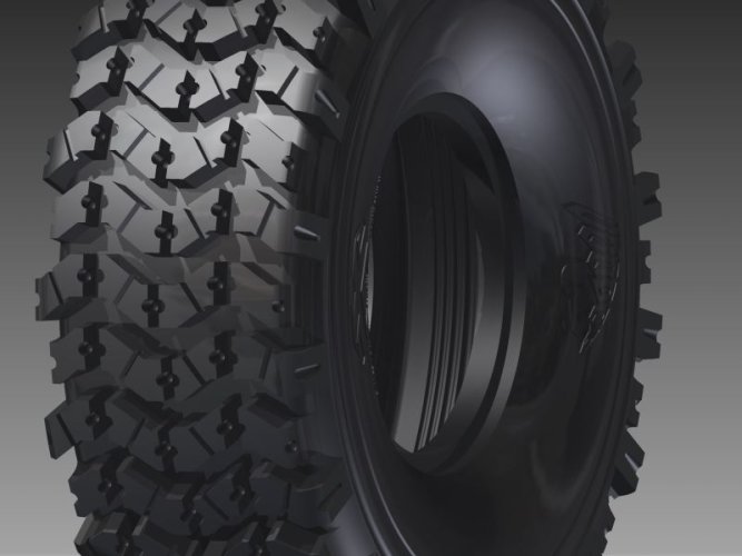

Can't wait to get my set of these bad boys ! First pic of the cad rendering of the new Ottsix Voodoo U4 tire. With the compounds he offers plus the tread pattern these tires are sure to eat up the rock and dirt !
