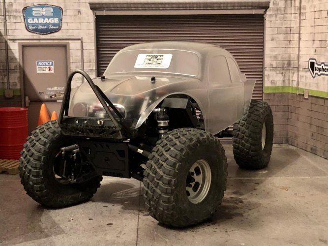

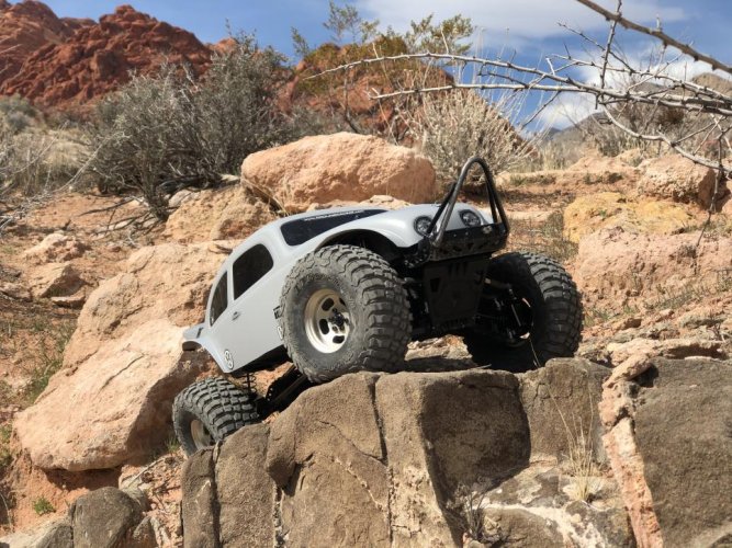

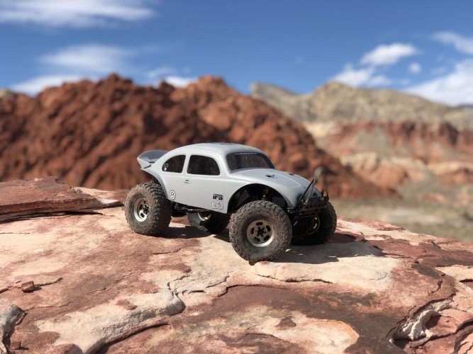

As you may have already seen, I’ve been excited about the IFS kit from Element RC to bring something a little different to the scale crawler market. After getting it in the mail I got to work and got it all installed.
Not much of note other than there are two plastic balls used on the servo link so it’d be a good idea to have a couple metal balls around for your install. And you’ll need a pretty small Allen wrench for the screws that hold in two hinge pins. It’s smaller than 1.5mm, I just found a bigger piece of hardware that would work since I didn’t have a driver that would fit.
I managed to get the SSD Brass Knuckles to work with little effort, there are a couple of shoulder ball studs that take some sanding to fit into the knuckles but once you get that cleared up it’s good to go.
Here are some pics, got it out for a shakedown today and should have some video together to share later. Shakedown was a success. Wondering if my shock position is making the front stiffer than it should be, going to mess around with that and get it back out for round 2.

The bug body looks great![emoji106] I like the nice and simple paint job! Looks killer out on them beautiful red rocks![emoji3]
Glad to hear the IFS kit was a somewhat effortless install.
Looking forward to seeing the crawling footage!
Beautiful Bug, Great job! Looking forward to the video and your experiments on the front shocks, I also feel them to stiff.
