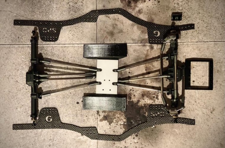

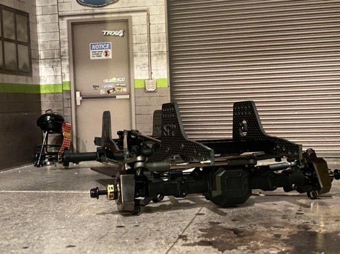

Started a new project this week. Taking an element enduro kit and slapping it into a carbon fiber gspeed v3 chassis.
Parts:
Element enduro kit
Gspeed v3 rails
TJRC skid
Gspeed multiplatform panhard mount
TGH DSM
Gspeed sliders
SSD Brass Knuckles
SOR rear link riser
Samix brass hexes
Body, electronics, wheels and tires TBD

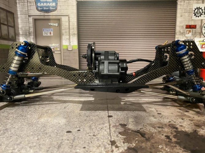

First off, I want to put out there that this was a breeze to build. If you’re hesitating swapping your element to a gspeed make note that this was the easiest one I’ve done so far.
Using the stock links, this skid, and the gspeed mp panhard mount everything fit perfectly. Wheelbase is right at 12.3” and front geometry is clean. No adjustments needed on any of the links.
Next up is shocks and mounting the stealth x "thumbsup"

This is a good swap IMO, one of my biggest complaints on the enduro is excessive ride height, that isn’t easily corrected with the stock chassis. Also, super weak panhard mount setup. The v3 chassis gives you good shock mounting options, solid panhard mount, good compatibility with enduro/scx parts, plus keeping the chassis light (one of my favorite attributes of the enduro)
Look forward to seeing it come together

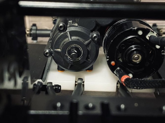

More progress was made last night. Got the shocks built and transmission mounted.

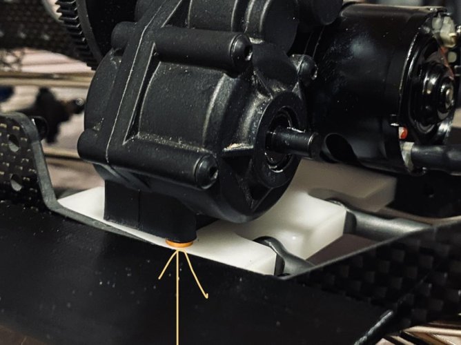

Although I’m using an enduro builders kit, I’m actually using a transmission that I had bought separately. The $51 version of the stealth x has plastic gears which are a bit lighter. Although plastic these gears seem to be tough as failures aren’t common, I will be running a crawlmaster sport so thinking it should work out well. If this was revolver powered I may rethink that. Unfortunately I lost one of the option gears so I’m stuck at the 5.7% OD for now. Hoping I stumble upon the 26t gear sometime soon or I’ll order a new one.
Since the gspeed has an angled skid, this also changes the angles of the outputs on the transmission unless it is addressed. To offset this, I used a 1mm metal spacer under the front two holes of the transmission. This helped get the inputs and outputs to be more parallel. Ideally I’d like to shave down the bottom of the case, maybe even at an angle, to help sit the transmission lower and address the angle but this will do for now.
Agreed, fixes a lot that wasn’t the best on the stock chassis. Excited to drive it and see how it does. Seems like a solid combo. "thumbsup"

Are you using the stock suspension link lengths?

It's almost like the GSpeed chassis was designed for the Enduro platform. They seem to fit together so nicely!:)
Shaving down the bottom of the trans would be a great idea I think since there is all the extra plastic at the bottom. Would be easy to set it on a belt sander at the right angle and take off just enough to make it sit right on the skid plate.
I agree on the stock plastic gears in the trans. They are wide and tough and see now reason why they wouldn't hold up. I've ran my stock plastic trans gears hard in my Enduro and haven't had any problems out of them. Also I like how quiet they are.
Yes, all stock links except the panhard now.
Thanks BMow! Good to hear about your plastic gears and good point on them being quiet. I’m thinking about getting a spare case to shave down here sooner than later. Getting that transmission lower would be nice.

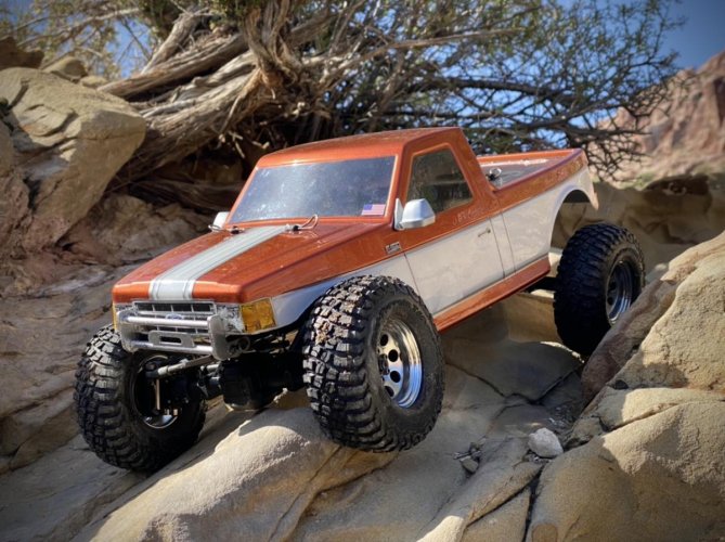

Got the body done as well. I went with a jconcepts tucked Ford body. Initially I was on the fence about keeping it on here. The way it’s tucked gives it kind of a boat like appearance, especially from the top. The whole side is rounded from front to back.
I ended up adding some Velcro to suck the sides in a bit and it helped some. After the initial paint job I also went back and added some pin striping to give the scheme some subtle depth instead of a raw two tone. Mirrors are from a trx4 sport. Although not the best shape for this body, these mirrors are tough. I took a sliver sharpie to them for the color.
After all that the body has grown on me. Looking forward to getting the ierc bumper on here to finish it off. I still may swap to a JP1 to match my other V3 but going to run it like this for a bit first.
Thanks for reading my ramblings if you made it this far, if all goes well I’ll have some shakedown footage after the weekend. "thumbsup"

Panhard looks like a perfect fit.
I like the paint scheme a lot, I’m on the fence with this body for the reason you mentioned, curved sides and all.
Don’t forget the firma can be programmed to some degree with a 1080 program card. I was pretty happy with the one in the rtr 10.3 I had briefly.
Looks great TB! It’s certainly an interesting looking body. While perhaps not a stunner, you did a nice job on it.

I do like the classic look with the two-tone paint! The mirrors are a great scale touch that makes it look even better! I agree, the body does look a little funny with how it is shaped, but the paint job kinda hides that look. Great job TB!"thumbsup"
It is hard to beat the look of the JP1 body! Love the look of them and would look killer on this build! I'm still trying to talk myself into spending the money to get one shipped to me since my LHS doesn't stock them!:cry:
