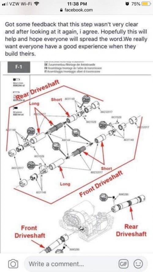

Great build and info on your Capra. One question, i had a hard time discerning which length of the drive shat goes where and the which length spline. Could you maybe make a little more sense of what is the correct way to put the shafts together?
Sent from my SM-N960U1 using Tapatalk
Awesome video!
Thanks! "thumbsup"
Here you go!
