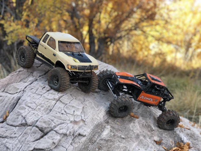

My brother was in town for the last few days so we got out to play with the tiny trucks. Clip below, more scenic than technical, and some pics.

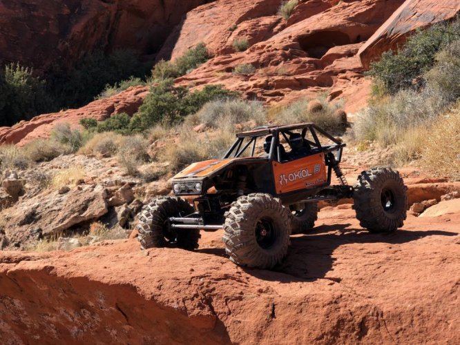

Got back out with the goat and a little different set up. Stuck with the 90mm shocks and changed to a more firm rear spring as well as adding vp 2.2 steel disc weights up front for some extra weight.
It climbed a bit better but I don’t like all the rotating weight so I’ll swap it out when some axle weight is available.
Electronics are still underwhelming me so I’m going to swap those out next.

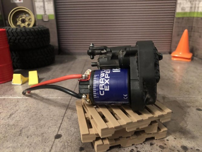

After kicking around the idea of going brushless, and talking with a few of you here about brushed motors, I decided to go for upgrading from the reedy Radeon 2 five slot to a Holmes hobbies crawlmaster expert 16t.
Got it installed tonight and am quite happy after a quick living room test. My biggest complaint about the reedy was the drag brake and secondarily the torque wasn’t what I was used to. Looking forward to trying it out on some rocks and seeing the improvement.
