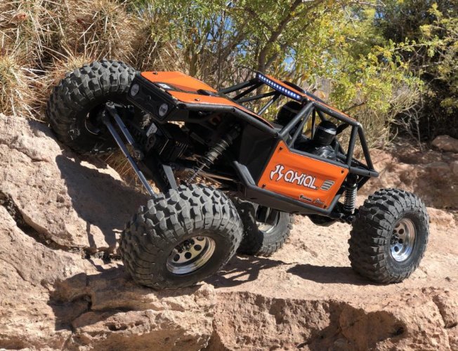

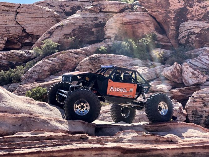

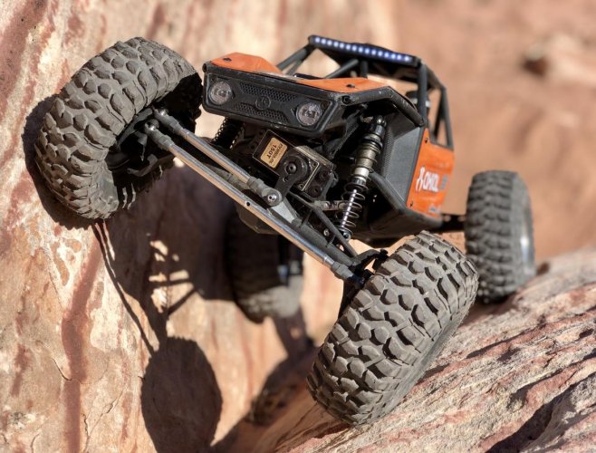

Got away for another quick shakedown to make sure the wheels clear fine, plenty of room with the SSD steelies. I have a new set (these were borrowed from the sendero) and some KLR/M’s on the way.
Few clips here. First dig equipped vehicle I’ve had, already finding it useful "thumbsup"

Looks like shakdown #2 was a success! Love how well it climbs over the rocks with ease!

Thanks BMow! Shakedown 2 went well. I’m itching to get some extended wheel time in.
New wheels and tars should be here Monday so I’m anxiously waiting for them too.
