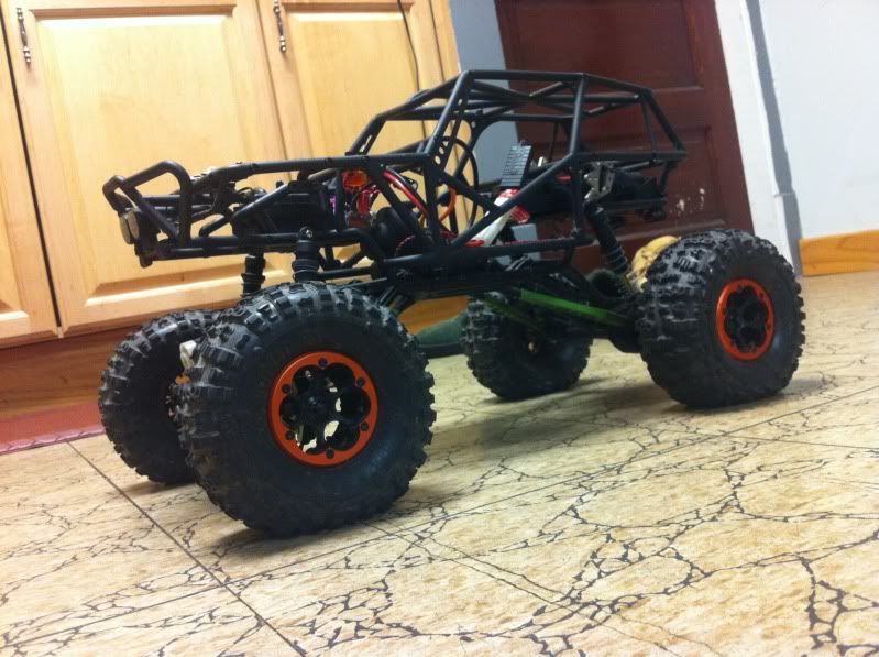

If you had read the post you would know that I temporarily stole that servo from buddy as to actually be able to use the truck.
I love the truck and I dont regret the money I spent...
The post was meant to do two things: Let someone who is doing research on a wraith with purchasing one in mind have a realistic look at the truck (obviously some people love theirs and took offense). Secondly I had hoped a few people could get a laugh out of it knowing they have had a similar experience.
I didn't have economy in mind but why would I purchase something that was going to break? And i definitely spent a little extra money on a few shinny bits.
ultimate point is that i should have been able to use it for more then 20 minutes without spending money.
Sorry for the long posts. Ill just do lists and pictures next time haha

For example, I'm prone to think that you broke the knuckles and damaged the shafts (the pin of the dogbone that did not want to stay centered) because nobody told you from the start to carefully adjust the steering EPA to avoid that at full steering lock the pin disengage from the slot in the drive cup, as the conseguence is immediate destroy of knuckle/"C" and possible damage to cup and dogbone itself.
I had rockcrawling with those stock parts, there's a video in Croatia this summer to prove it, and yet have not broken a single shaft or C.
A Wraith can be used mostly stock without breaking anything if you just de-rate the speed with shorter gears ratio and use it as something just slightly faster than a crawler.
But if speed is what you like for the Wraith, speed demons live eating coins at dozens at a time! Talk about spare parts!
My Wraith is set as a dedicated cralwer, and still uses stock plastic "C" and knuckles and till now nothing broke.
Yes had to made my own tie rod and suspension links, but no biggies.
