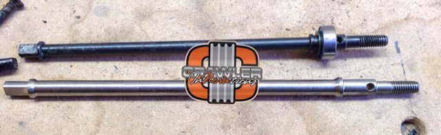

Good performing, well built trucks just keep on going and this rig is no exception. It was time to upgrade the track width to the same front and rear though. A PM to Creeper Bob is all it takes for some titanium axle goodness.
..Uploaded from the lab @ the C.I. Compound...
